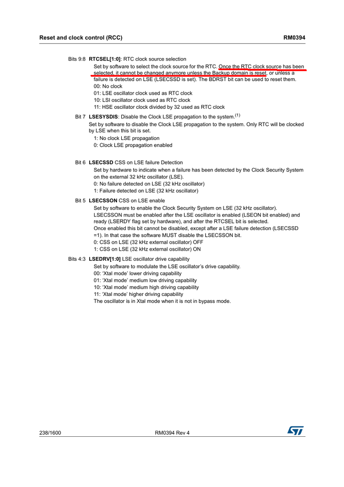

2018-12-19 9:47 PM
It means, that you can't simply switch sources of RTC. The only way would be to read the current time/date, reset backup domain (see BDRST in the same register), if switching from LSI to LSE then start LSE, switch to the required clock source, and set up RTC completely again.
You'll lose some of the timing precision, of course; but LSI is so imprecise that this probably wouldn't really matter.
Maybe you want to tell us why do you want to do this switchover, and maybe there are better ways how to solve the problem.
