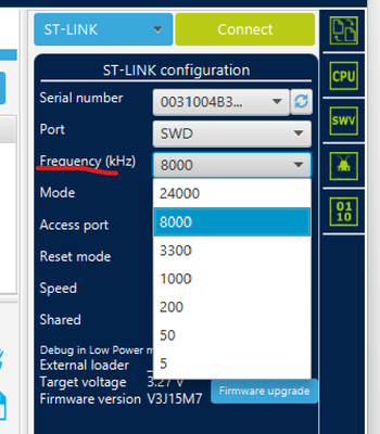

The frequency of SWD signals is configurable and can be quite slow. You should be able to find a setting that works.
