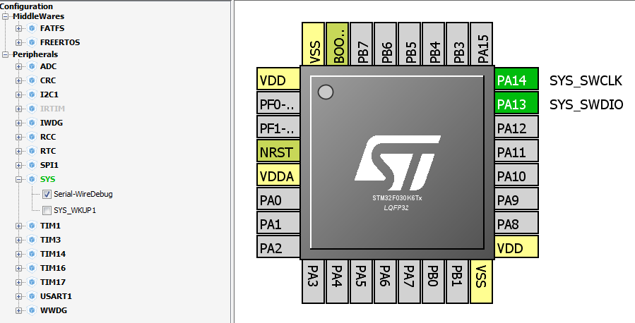

i made my stm32f030k6t6 board and i connect it to stlink
after that i generate keil V5 project using stmcube .i enabled the SWD pins only , after that i compiled the program and download it ,i start the debugger ,but when the program execute the [HAL_RCC_OscConfig()] the debugger send message that it cant communicate with core and every thing stop working ??2015-11-17 4:41 AM

Hi mohammed_sayed,
With CubeMX generated code, pins are set to there default status if not configured with the tool.To be able to debug the STM32F1 device in SWD mode, you have to select ''Serial-Wire'' in SYS configuration (Pinout wizard).-Mayla-To give better visibility on the answered topics, please click on Accept as Solution on the reply which solved your issue or answered your question.

thank you for replay
first i use [HSI] with default trim ,then i passed it to PLL with (x12) PLLmul to achieve 48MHZ (max clock speed ) i traced the code and i found that the stlink lose connection with target gust after enable pll using [__HAL_RCC_PLL_ENABLE();]if i reduce the PLLmul less than (x6) it run finei also test Ulink 2 and the same result @Mayla i did what you mention in stmcubeWe’re moving the ST Community to a new platform to give you a better and more reliable community experience.
