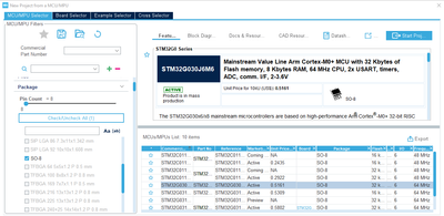

Hello @prakashdandekar and welcome to the ST Community :smiling_face_with_smiling_eyes:.
I suggest you to use the MCU/MPU filters of CubeMX to make a choice about whish product will be the best for your needs:

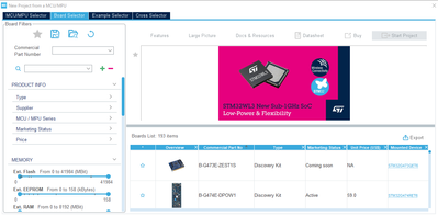

Also, you can take a look at the available board for each MCU series looking at the Board Selector of CubeMX:

2023-12-08 12:40 AM
