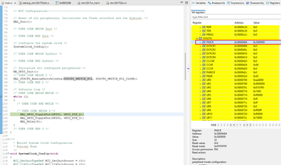

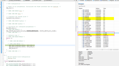

Hi @Andreas Bolsch , here are the values of these registers (0x580244F4, 0x58024554, and 0x58000404) after call:
HAL_SYSCFG_AnalogSwitchConfig(SYSCFG_SWITCH_PC2, SYSCFG_SWITCH_PC2_CLOSE);
2024-04-03 1:49 AM
Hm, these value are indeed correct. So the problem must be in hardware. Revision 'V'?

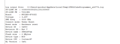

Hi @Andreas Bolsch, FYI, here is the chip information on NUCLEO-H753ZI Dev-Kit:
2024-04-03 2:02 AM
PS: there is no difference between different silicon revisions in term of PC2_C pin.
