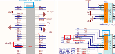

On which connector are you probing PC2_C pin? CN9 or CN11?
If on PC9, what about the SB53 solder bridge? is it soldered?
Could be better to check the continuity between the MCU pin (pin 28) and the connector pin to be sure the HW doesn't present an issue.
2024-04-03 12:56 AM

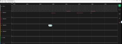

Hi @mƎALLEm , I attached a probe to CN11 (PC2), soldered the header, and measured the signal there.
