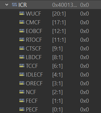

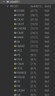

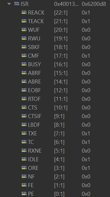

When I run this code with the debugger, the first interrupt goes into the RXNE case, then immediately enters the ISR again and none of the status checks return true, so the code just keeps entering the ISR repeatedly and none of my RTOS tasks run. The state of the USART1 ISR, ICR, and CR1 registers while "stuck" in the ISR follow:
I see the Overrun bit set in the ISR register, which makes me think the USART1 is interrupting due to and RX overrun, but why isn't it getting cleared in the interrupt service routine (ORE case)?
