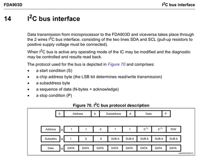

The write procedure is given in the datasheet.
This is a simple 2-byte write to the slave address. Any I2C library can handle this. On the STM32, it could be a single call to HAL_I2C_Master_Transmit() with the two bytes as the payload.
