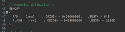

Dear TDK:
The project I created using CubeIDE should not have any issues with link file exceptions, and I have also checked the. ld link file. The size of the Flash space allocation is also 1MByte.
Best Regards!
2024-07-30 4:48 AM
Dear TDK:
The allocation of RAM and Flash in my link file is also the same as yours:

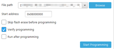

You can see that my burned file exceeds 512KByte:
I have checked the 'Verify after downloading' option:
As shown below, the verification failed at position 0x08080000:

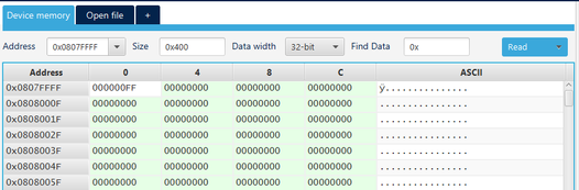

Reading the data at position 0x0807FFFF, it can be seen that the data in the subsequent FLASH is all 0:
Best Regards!

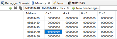

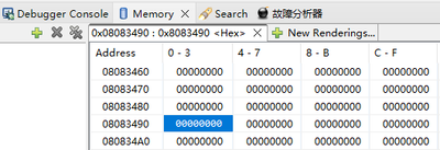

Downloading 524 bytes @ address 0x080834A0 - Verified OKI tried to read the data after 0x08080000 in the debugging window, and the result was the same:
Best Regards!
