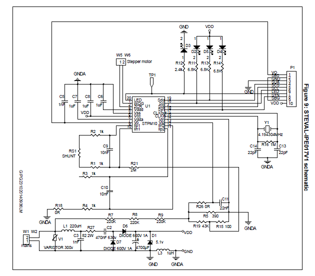

I am not going to use E4622 current sensor. I will use shunt resistors for current, and for voltage measurement, one resistor divider, as shown in below image.
Then, I will tie SPI ports to another microcontroller. I understand that if I use the same VDD-GND that powers the meassurement unit for that another microcontroller, I will not need isolation. But If I use another power supply, Will I need isolation for SPI port or it is enough by using a good isolated power supply?.
In general, problems with PC RS232 connector is because of PC power supply is not isolated??
Thanks a lot.
Francisco.
2017-12-26 3:13 PM
Yes, 2 microcontrollers, with a good ground between them, there is no need for isolation.
Yes, the PC has a proper earth-ground outside your house. full of noise...
Your isolated power supply's negative terminal will drift upto 400V above ground until it is tied to the PC ground.
