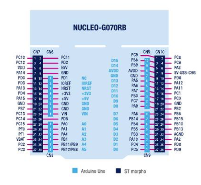

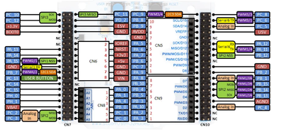

Hi JW, Now it explains as I used the incorrect pinouts and the pins where swapped! as below diagram (wrong one is at the bottom).
2024-04-02 1:22 PM
Thanks for coming back with the solution. Please click on "Accept as solution" in that post so that the thread is marked as solved.
Where is that incorrect picture from?
