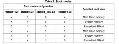

Hello @GOnkelinx ,
You can refer to the table 7. Boot modes page 51 of the RM0454 rev5.
If you want to control the access to the bootloader through boot pin, you need to put nBOOT1 bit =1, nBOOT_SEL bit=0, nBOOT0 bit = no importance. And following the level of BOOT0pin after reset the device will boot from system memory (bootloader) or flash memory.
