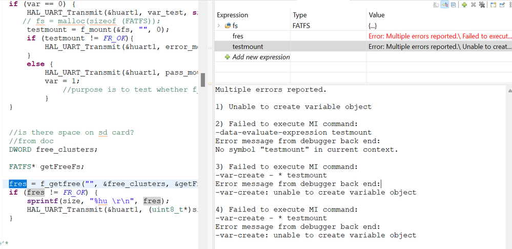

2024-02-21 6:23 PM
I get a return value of 1 for my mount function. For the getfree function, I receive this error in debug mode:
and it also gives a hard fault error. No message after the getfree function is transmitted.
2024-02-21 7:46 PM - edited 2024-02-22 9:39 AM
More updated error message:
Another update: when I remove the getfree function and change the f_mount param to be able to force mount, I then get the error message at the testmount, which leads me to think I have an issue with the mount function. I'd greatly appreciate any insights into the matter.
