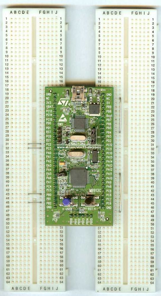

Yes, you can The only question is: what to do about that pesky row of pins along the bottom?! Here's what I did:
2011-03-24 3:59 PM
We are using the long protoboards from dipmicro.com with strip sockets. The boards are high quality, plated through FR4 with solder mask.
Because they are designed for SMT DIPS with 0.05'' spacing, the outer set of contacts are separate from the inner sets, so you can use 0.1'' parts under the Discovery board without conflict. You can handle the end contacts most easily by not installing a socket strip, but it was just a minute or two of effort to cut the traces between holes at the end.2011-03-25 12:10 AM

One advantage of a ''pad-per-hole'' board is when you have both ''horizontal'' & ''vertical'' rows of pins - as on the Discovery board...
