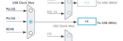

I’m currently using the internal clock source, specifically the 48 MHz HSI48 oscillator for USB. Is this oscillator accurate enough for USB operations, or is it preferable to use a PLL-generated 48 MHz clock? Unfortunately, I don’t have an external crystal available.

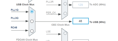

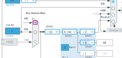

When I try to configure the USB clock using a PLL (e.g., PLLQ) with HSI, I encounter the following error in CubeMX:
“PLL Mux should have HSE as input”

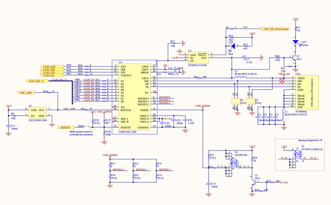

Also, I’m following the same layout as the schematic of the Discovery board. Has anyone experienced similar issues or found a reliable configuration without an external crystal?

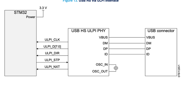

When using external HS PHY, clock is provided by that PHY through the dedicated OTG_HS_ULPI_CK pin.
The system clock primary source shouldn't matter, only the clock should be fast enough so AHB is able to feed the OTG ULPI interface:
To guarantee a correct operation for the USB OTG_HS peripheral, the AHB frequency should be higher than 30 MHz.

okey thanks, but in HS, i must used an external PHY, which has its own cristal/oscillator, so why do i need an external crystal clock for the MCU? In that case, the CLK is generated by the ULPI, not by the MCU
Regards,
You can use HSI for the core clock if you're using an external crystal for the USB HS PHY.
Following your steps as best as I can understand them, I don't get this error. Please include the IOC where you get this error.
