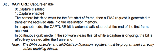

Is the capture bit enabled?

I do not know what you mean with capture bit. Is it something to configure in u5 microcontroller ?.

The CAPTURE bit is a bit in the DCMI_CR register.
