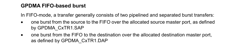

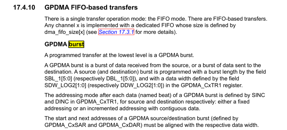

i am going through deeper configuration of GPDMA on STM32U5 and there are some things i do not understand.
S/DBL_1 in TR1 register is able to vrite destination/source burst length in range 0-63 but FIFO size is 8 bytes for channels 0-11 and 32bytes for channels 12-15. Why is burst length possible to set up up to 64? How is GPDMA able to buffer that into FIFO? Isnt it a mistake in RM0456?

why mistake ?
- one is the capability of the DMA , burst settings
- other is the FIFO size
So you can set the burst to be smaller or fit the fifo size, but also make big bursts, if you need this,
no matter, it will be all in fifo or not.
Up to you, to choose the optimum setting for a certain application/use case.

I am sorry but what?
Burst transfer is not based on FIFO? Then how do you activate using FIFO? How do you configure FIFO? How do you want to configure different burst count of source and destination?

from rm:
No. You can transfer lets say, from mem to mem, in burst - using no fifo.
