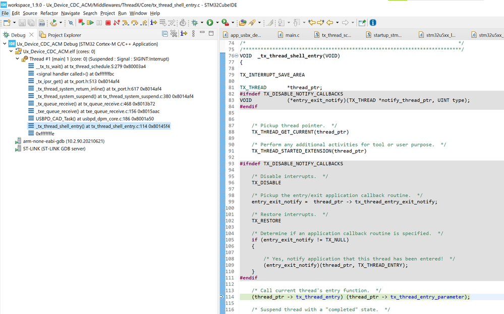

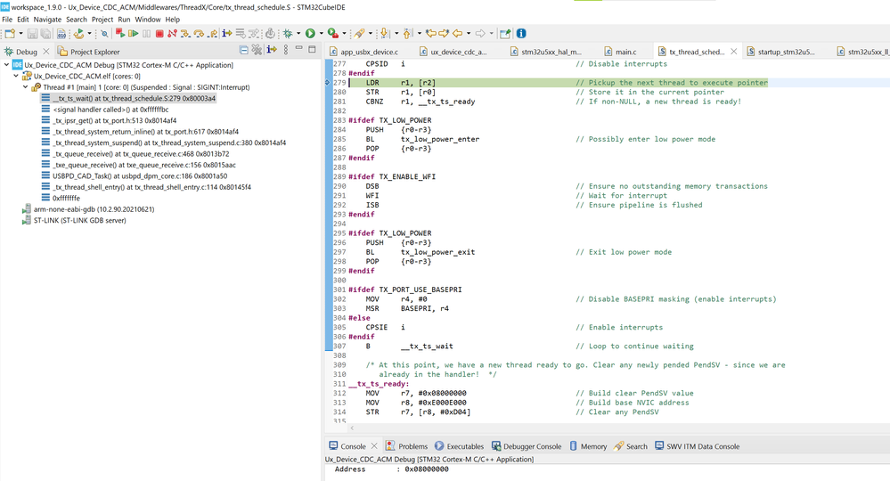

When locked, the debug show as:
Does anyone know what is the problem? Thanks.
