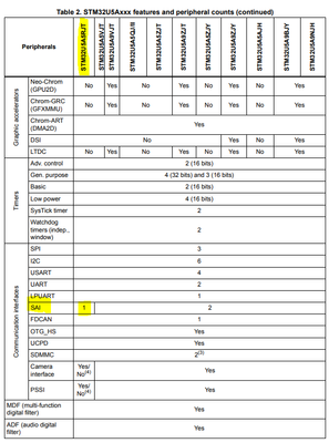

I have not seen table 2 (telling me just one SAI) - OK, got it.

Thank you for this feedback. The STM32U5A5RJT6Q (LQFP64) have one SAI as mentioned in the datasheet table 2 based on that it didn’t have an SAI2.
The "STM32U5Axxx pin/ball definitions (1)" table covers all IP available on that pin regardless of package. The customer should be referred to availability of IP on his product package. This behavior is explained by this note:
"1. Function availability depends on the chosen device."

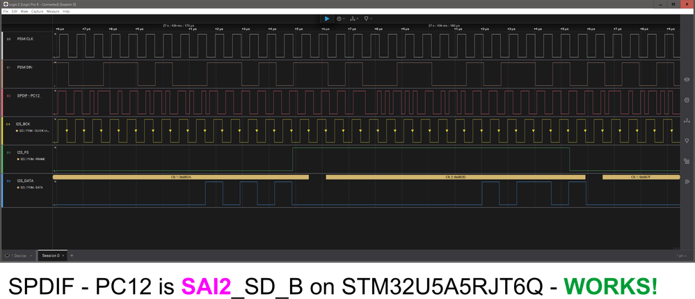

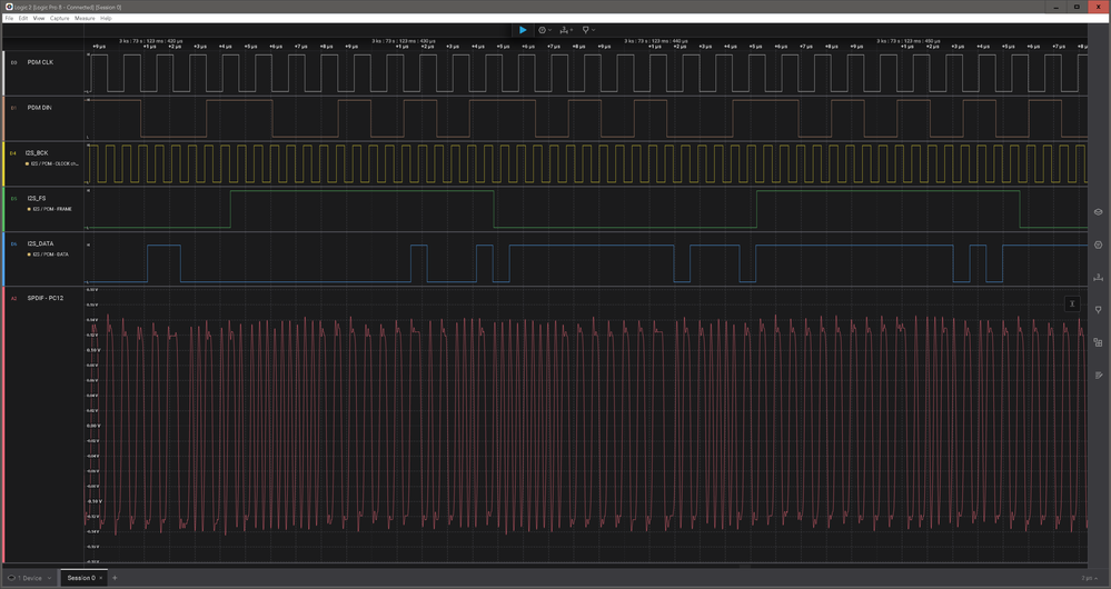

I can REALLY confirm now: even the STM32U5A5RJT6Q package (LQPF64), even mentioned in STM datasheet - it has also a SAI2 (not just one SAI).
I can configure, I can use, I can forward via PC12 as SAI2_SD_B and generate an electrical S/PDIF output: it works, I get the PDM audio on the external S/PDIF receiver.
Here a video about the setup and the proof that it works:
Here the waveform for all audio signals in system:
The PC12 output here is "analog" (with external S/PDIF circuit) - it works!
