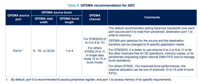

However, there are no specific SRAM location limitations for DMA transfers on the U5, but if the buffer assigned for the transfer isn’t 32-bit aligned, this could be the issue!
You can check this table in AN5593:
Also, it would be better to share your cubeMX configuration!
