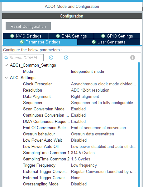

2026-01-19 6:33 PM - edited 2026-01-30 8:09 PM
Thanks @Saket_Om , I could get it to work.

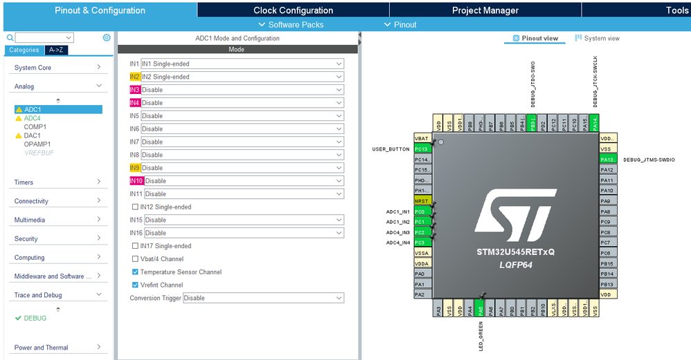

I am sharing my implementation for review and suggestions by the Community. The complete project can be found at https://github.com/NereusF1/ADC-DMA-Test_N-U545RE-Q
Tested using NUCLEO-U545RE-Q.
ADC1: VREFINT, IN1, IN2, Temperature Sensor
ADC2: IN3, IN4
ADC calibration done at start-up
CubeMX settings

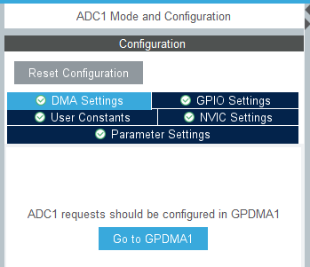

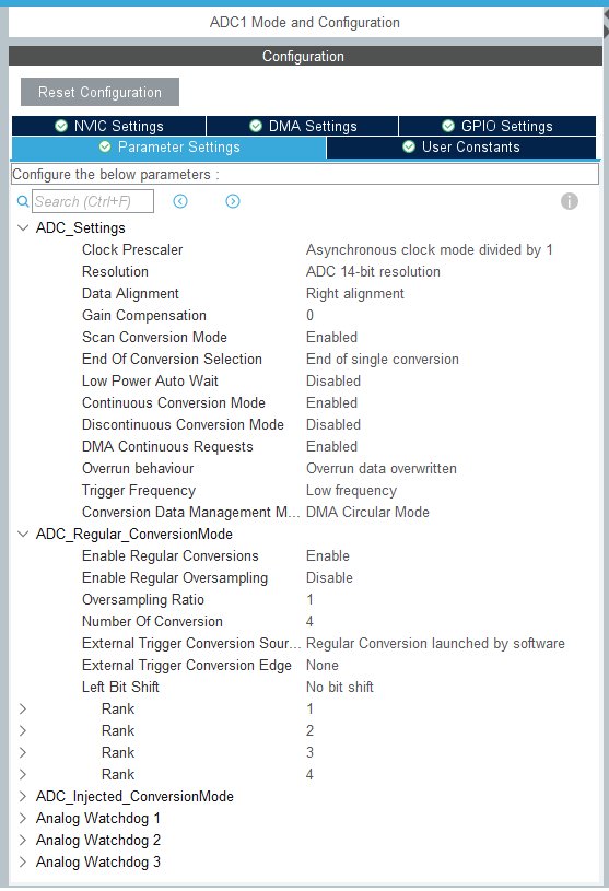

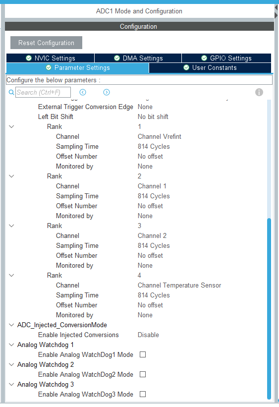

ADC1 Configuration
If using both ADC1 and ADC4, they would both need the same Clock Prescaler setting: Asynchronous clock divided by 1 (?)

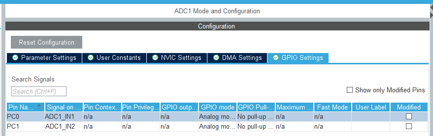

No changes required in the GPIO Configuration done automatically by CubeMX.

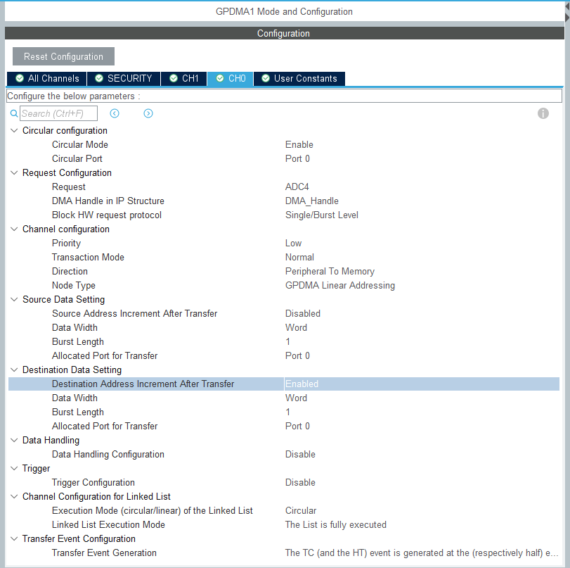

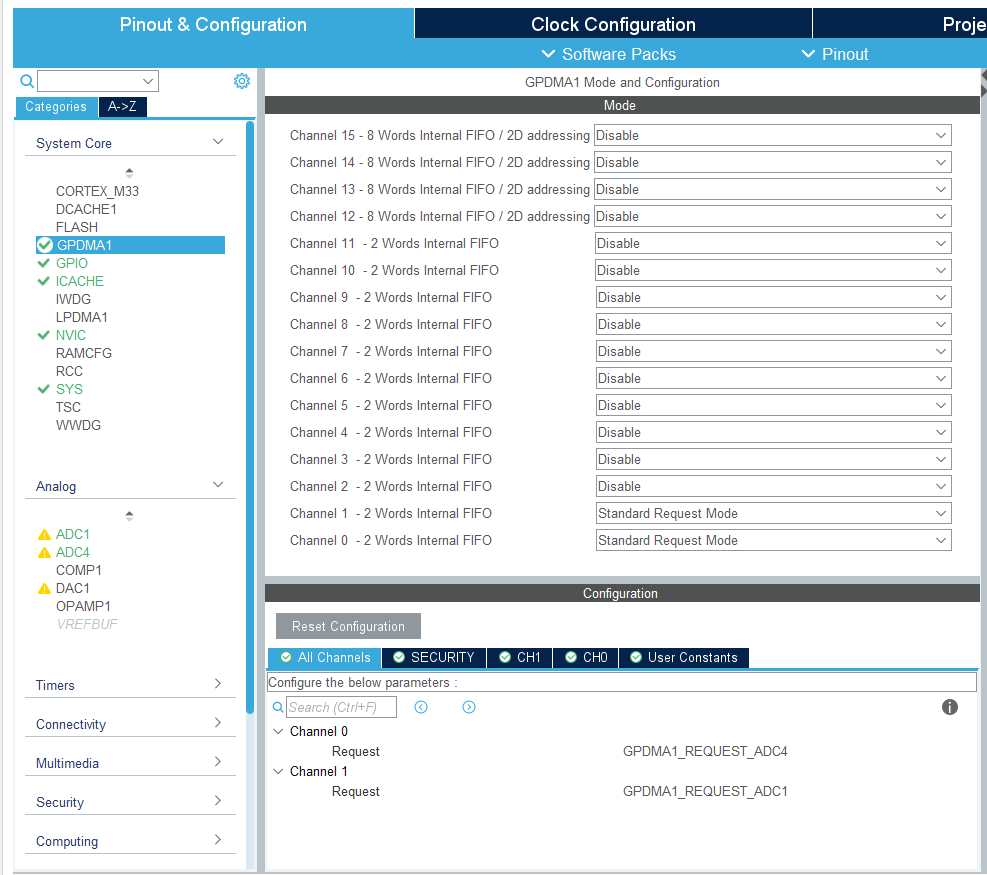

DMA configuration is done at the GPDMA1 node in CubeMX.

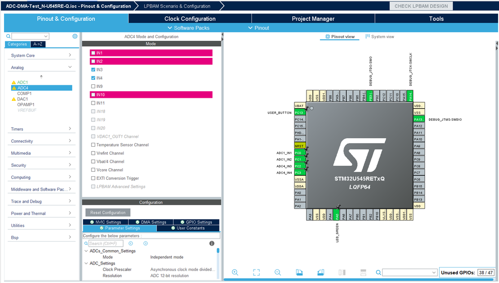

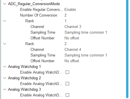

ADC4 Configuration

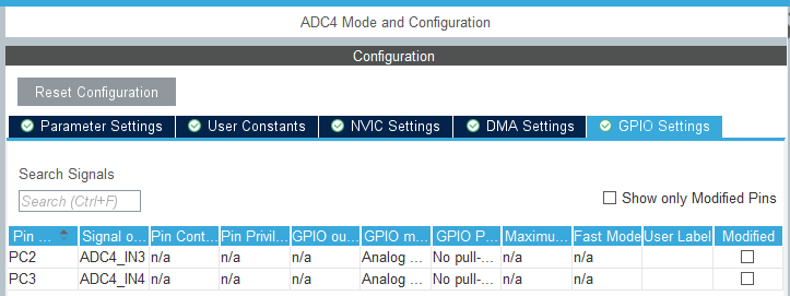

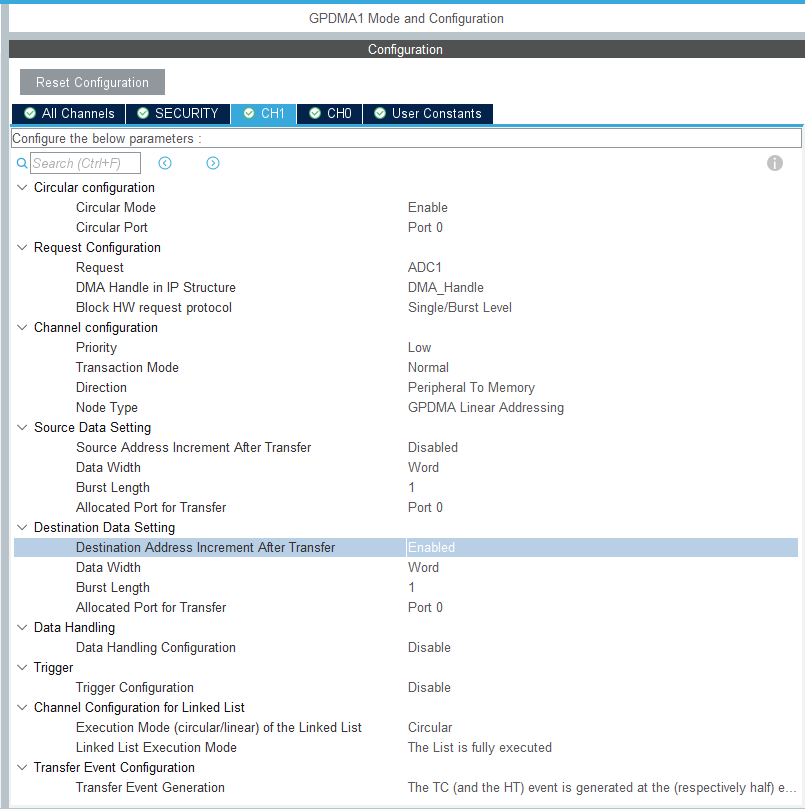

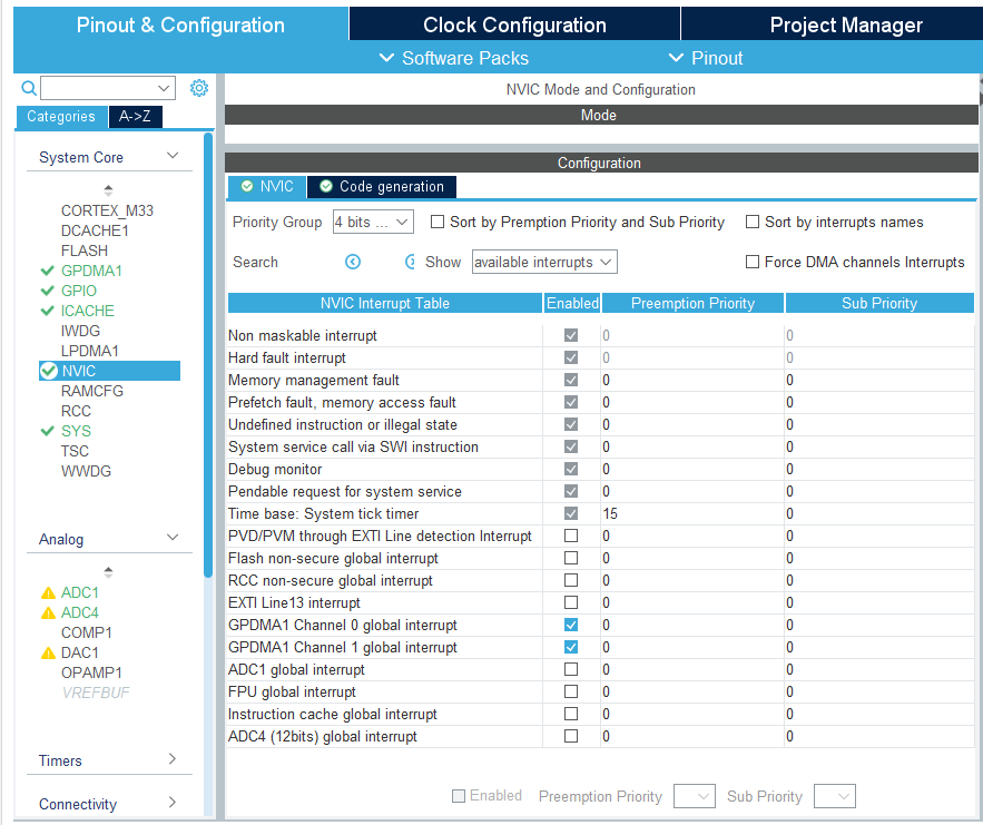

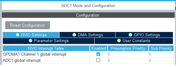

Assign DMA Channels for ADC1 and ADC4
Configure DMA CH1 for ADC1
Configure DMA CH0 for ADC4

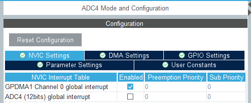

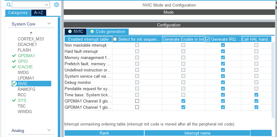

In the NVIC Node, Enable DMA Channel 0 and Channel 1 Interrupts
No changes required in the NVIC Code Generation done automatically by CubeMX.

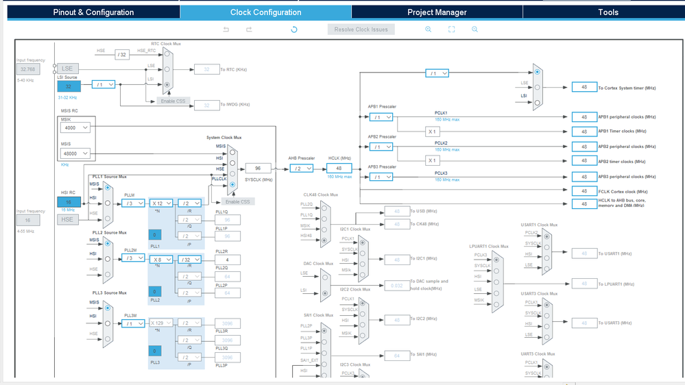

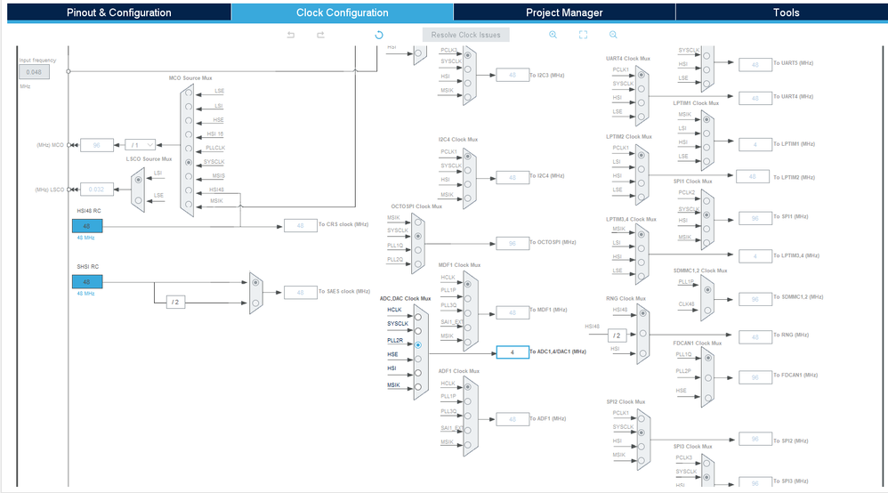

Since my process values are slow moving DC values, I am using slower 4MHz clock for ADC.

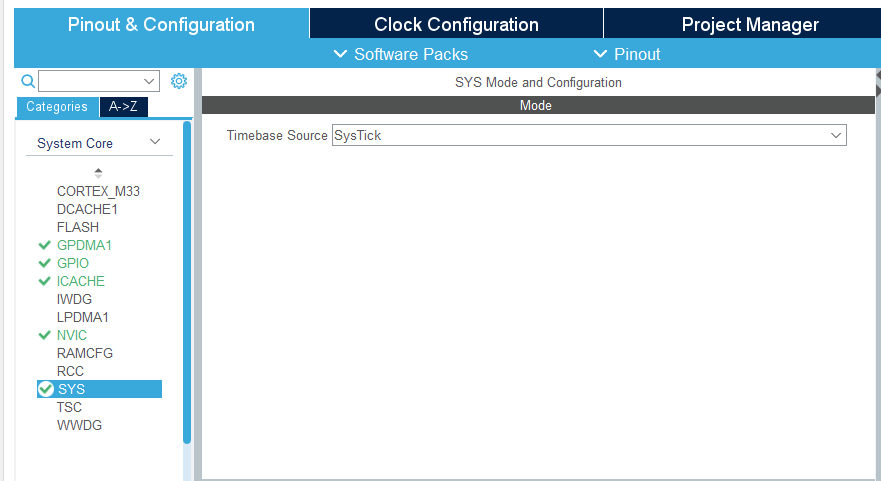

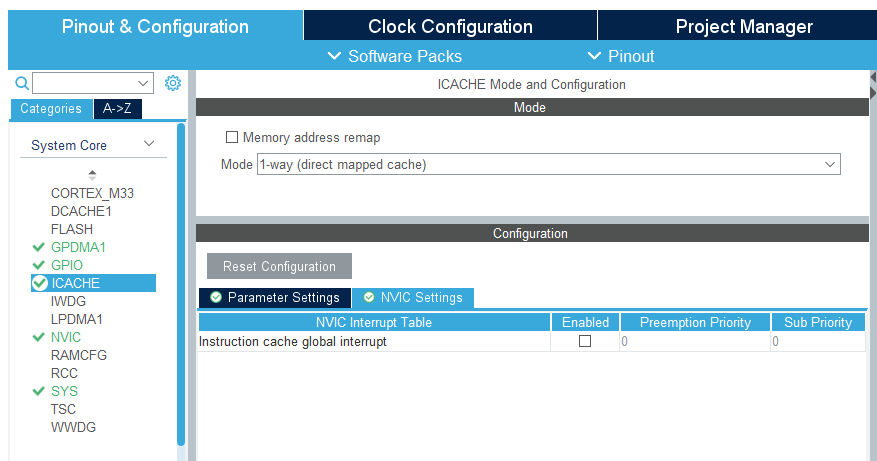

Use the CubeMX default.

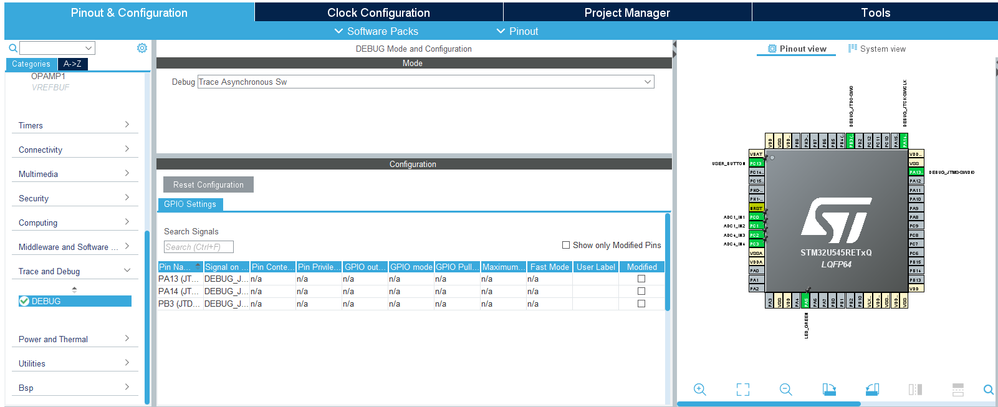

To support printf for the Debugger.

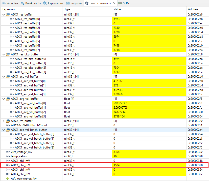

TCONV per channel = TSMPL + TSAR = [814_min + 17_for_14bits] × Tadc
TCONV per channel = 831 × (ADC_Clk_PreScaler/Fadc) = 831*(1/4Mhz) = 207.75us
For ADC1 with 4 channels = 207.75us x 4 = 831us ~ 1ms assuming delays for the DMA buffer complete call-backs.
Now accumulating 100 samples = 1ms x 100 = 100ms.
So every 100ms we hand-over a new accumulated count from the Conversion Complete Call-back functions.
Hence the earlier accumulated count should be processed before this new accumulated count arrives to ensure
that we do not miss some readings.
I plan to move this checking / processing to a 10ms timer loop in production code.
Readings are within +/-10mV of the signal source.
