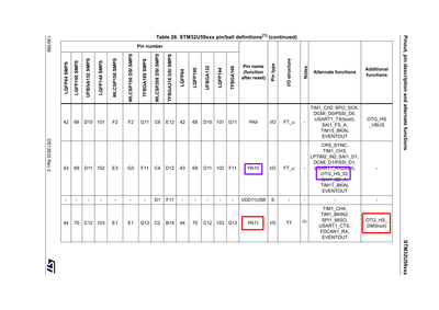

Hi @Sarra.S ,
Note, that PA11 which is the pin in question, is *not* OTG_HS_ID; it's OTG_HS_DM i.e. one pin of the transceiver itself:
PS. The (boot) after the signal name is very confusing. Can it please be removed, and replaced by footnote?
2024-02-07 8:01 AM
Hello @waclawek.jan
Thank you, I'm sorry for the misunderstanding!
I've reported your request about the footnote
