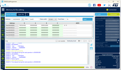

2023-11-09 6:05 PM
This picture is the MCU message read by STM32CubeProgram.

2023-11-12 5:59 PM
The value is 0X30016481 @0xE004 4000.
