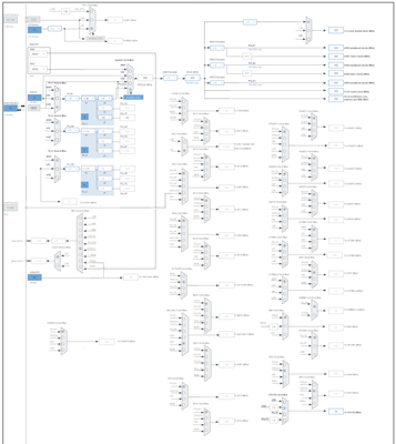

Here is my complete clock tree, which doesn't work - just switching OTG HS to PLL1P resolves the issue:

Hi @FBL
The HSE clock is a 32MHz 10ppm crystal.
The only input to OTG HS Clock Mux which does not work is HSE/2 at 16MHz.
Using HSE input at 32MHz works and PLL1P at 16MHz also works.
btw with a 32MHz input, PLLM divider cannot be 1 - it exceeds the maximum frequency.
If you need me to provide any additional information, do let me know. Thanks.
Lukasz
