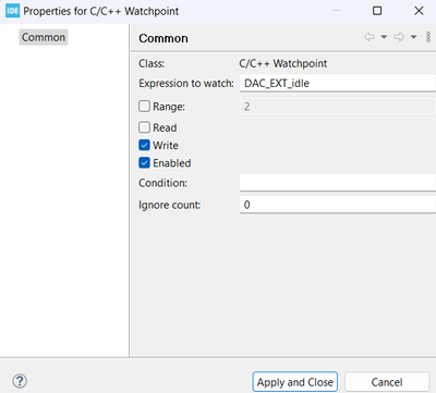

So I have this DAC_EXT_idle uint16_t, and I managed to add watchpoint to that
Surprisingly enough, the breakpoint triggers at this instruction

edit:
this is how watchpoint is set up, with or without range enabled I get the same breakpoint
more edit:
culprit probably found, debug correctly pointed the instruction AFTER the problematic one. It was an array writing under interrupt, but array index managed outside the interrupt.
