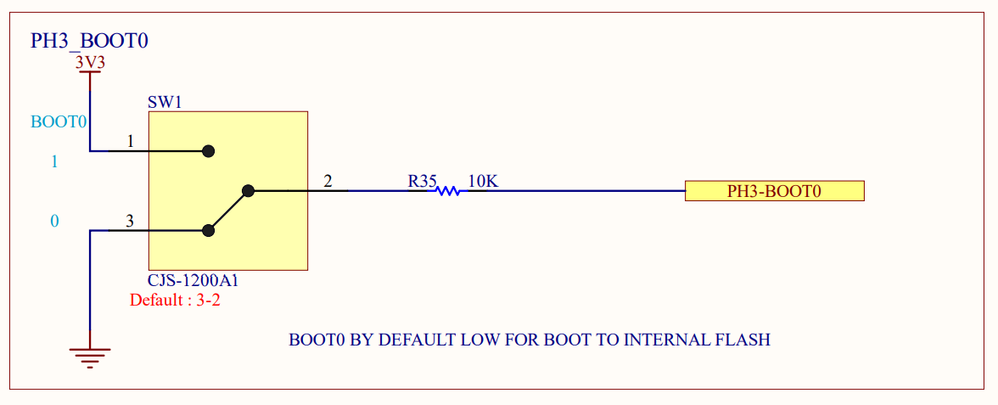

2025-10-13 6:16 AM
Hello @shivss,
The rework mentioned involves setting PH3 (BOOT0) to high. In the case of STM32U585I, there is a small switch just above the reset button that you can use to toggle it.
Best regards,
2025-10-13 10:19 PM
I set PH3 (BOOT0) to high using the switch above the reset button and confirmed the change. I then tried again, but I’m still getting the same result — it’s not unlocking.
