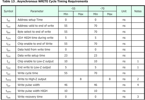

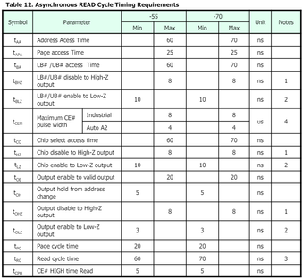

PSRAM time is below.

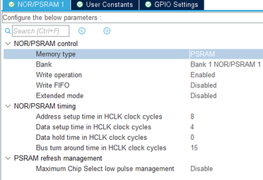

My Cube configuration is below.
Here is configuration.
// fmc init code
hsram1.Instance = FMC_NORSRAM_DEVICE;
hsram1.Extended = FMC_NORSRAM_EXTENDED_DEVICE;
hsram1.Init.NSBank = FMC_NORSRAM_BANK1;
hsram1.Init.DataAddressMux = FMC_DATA_ADDRESS_MUX_DISABLE;
hsram1.Init.MemoryType = FMC_MEMORY_TYPE_PSRAM;
hsram1.Init.MemoryDataWidth = FMC_NORSRAM_MEM_BUS_WIDTH_16;
hsram1.Init.BurstAccessMode = FMC_BURST_ACCESS_MODE_DISABLE;
hsram1.Init.WaitSignalPolarity = FMC_WAIT_SIGNAL_POLARITY_LOW;
hsram1.Init.WaitSignalActive = FMC_WAIT_TIMING_BEFORE_WS;
hsram1.Init.WriteOperation = FMC_WRITE_OPERATION_ENABLE;
hsram1.Init.WaitSignal = FMC_WAIT_SIGNAL_DISABLE;
hsram1.Init.ExtendedMode = FMC_EXTENDED_MODE_DISABLE;
hsram1.Init.AsynchronousWait = FMC_ASYNCHRONOUS_WAIT_DISABLE;
hsram1.Init.WriteBurst = FMC_WRITE_BURST_DISABLE;
hsram1.Init.ContinuousClock = FMC_CONTINUOUS_CLOCK_SYNC_ONLY;
hsram1.Init.WriteFifo = FMC_WRITE_FIFO_DISABLE;
hsram1.Init.NBLSetupTime = 0;
hsram1.Init.PageSize = FMC_PAGE_SIZE_NONE;
hsram1.Init.MaxChipSelectPulse = DISABLE;
/* Timing */
Timing.AddressSetupTime = 8;
Timing.AddressHoldTime = 0;
Timing.DataSetupTime = 4;
Timing.DataHoldTime = 0;
Timing.BusTurnAroundDuration = 15;
Timing.CLKDivision = 16;
Timing.DataLatency = 17;
Timing.AccessMode = FMC_ACCESS_MODE_A;
