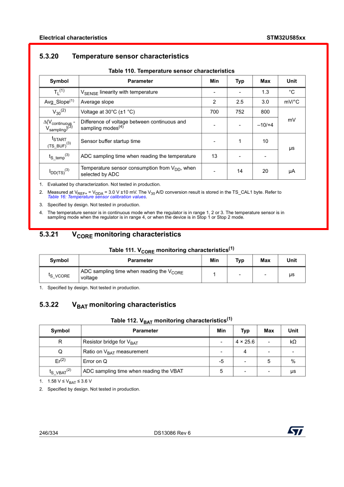

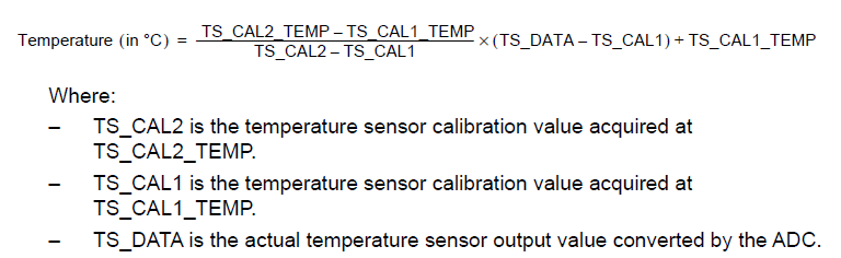

Coefficients are in the datasheet and transfer function in the reference manual. The sensor's temperature range should be the same as for the chip junction, which is also in the reference manual.

Hello Piranha
Do you mean the blow function? What I want is the function of output voltage Vs temperature.
Also with some typical value. I read one for the Micro, the data is 4095 for 30C, 5455 for 130. Based on this, it is 2.49mV per Kelvin. Is it your typical value for the transfer ratio? What is the error for this ratio. If we assume it is a linear relationship. I believe the error is from the offset and coefficient. When you perform the calibration, I think these 2 errors have been calibrated. What is the error for the temperature sensor after calibration? Can I say the error for the temperature is +/-1K? Or maybe =/-5K

This is a primarily user-driven forum, with casual ST presence. I can't give you more information than what's in the datasheet, see above.
The max. 1.3deg.C VSENSE linearity error presumably covers the whole operation temperature range. This assumes, that you don't make additional errors (e.g. through unstable VREF+/VDDA/VSSA etc.) when taking the ADC measurement.
If you need more information, you may want to talk to ST directly, through your FAE or web support form.
