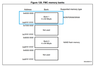

According to the RM0456 / Figure 120:
The PSRAM memory region is at 0x6XXX XXXX.

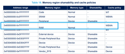

And according to the PM0264 "STM32 Cortex®-M33 MCUs and MPUs programming manual"/ Table 19:
That region attribute is by default cacheable: Write-Back\Write-Allocate (WBWA). So normally no need to configure the MPU to set it cacheable.
