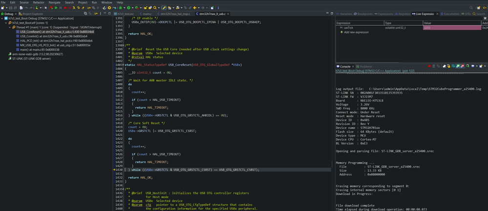

1) When initializing the USB - HS peripherals, I getting stuck in the "USB_CoreReset" function:
Related problem
and after some time when (count > HAL_USB_TIMEOUT) the program goes to Error_Handler(). This happens identically when I initialize the project with the board selection (file nucleo_h7s3l8_test.rar)

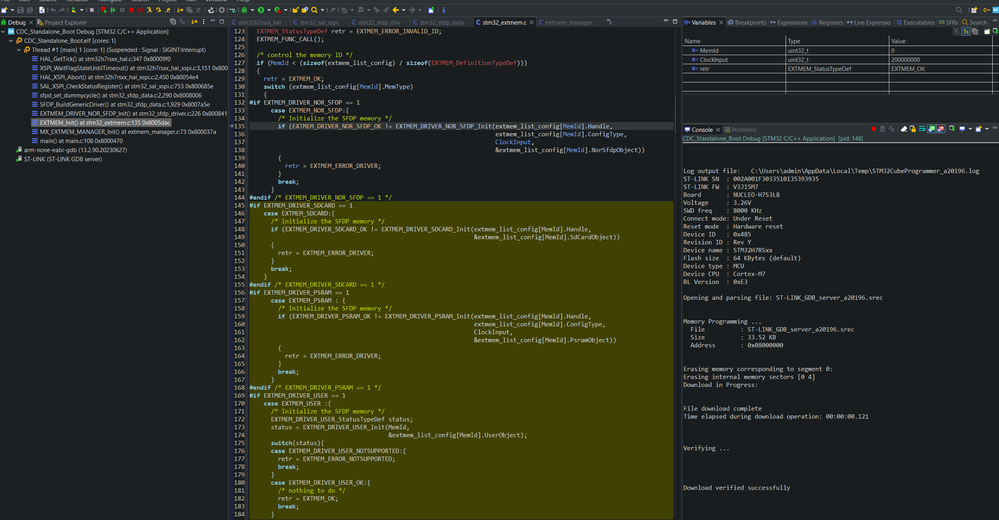

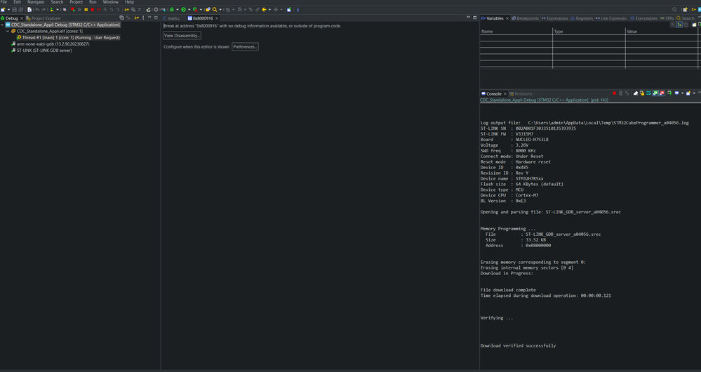

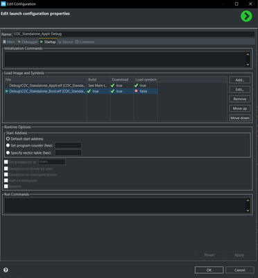

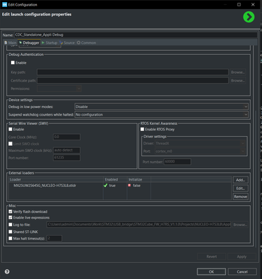

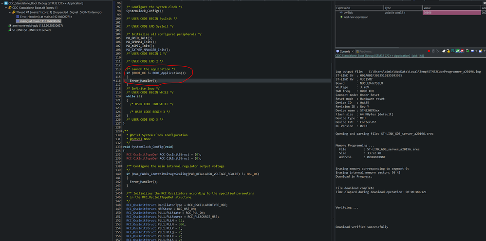

2) Then I started digging into the examples and using the UM3294 instruction 5.2.3 Developing an application in the external flash memory, page 21
The project is presented below: STM32Cube_FW_H7RS_V1.1.0\Projects\NUCLEO-H7S3L8\Applications\USB_Device\CDC_Standalone
But the program never goes into debug and gets stuck at a strange address.
I tried to run only ..._BOOT but the initialization of the external memory is going through errors and as a result, the transfer of control to the external flash does not occur.

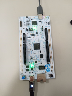

I am attaching photos of the ordered board:

Hi @Shpegun60
Check compiler optimization and set it to None. It could be linked as well to synchronization with PHY frequency and CPU frequency. I assume this is quite complex to insure in the USB_CoreInit function. If still having issues, try to decrease CPU frequency.
