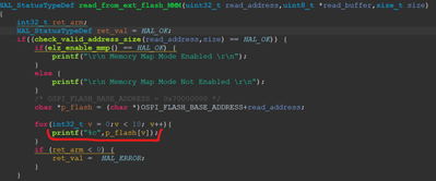

I am working with stm32u585 interface with Ext-Flash. I have SBSFU code in that I am doing external flash initialization(Indirect mode) in Boot code (boot_platform_init) to check firmware is available for update or not . Then after switching to secure next Non secure. In Non secure part I am doing initialization(Indirect mode) again and Reading / writing / erasing is working. after that I am switching to Memory map mode and I am getting memory map enable success command and trying to read the data at address 0x70000000, then program got stuck here .

->Stuck where? Are you getting a Hard Fault or Mem Fault? Would you know? Do the handlers output any diagnostic information so that you'd be aware.
It's getting Mem Fault, The program got stuck to that particular line (picture shown below).
-> Is it stalling the MCU doing the External Flash read? It there are timeout? Can you program this memory normally via an External Loader?
yes, (as shown above picture). No timeout has approached as of now.
