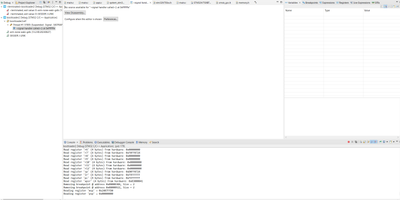

Hello everyone. I am trying to write a bootloader with STM32H750IBT6 and mt25ql512. I am trying to adapt the ExtMem_Boot example of STM32H750-DK to STM32H750IBT6 by modifying it, but I can't succeed. It doesn't make sense why STM32H750IBT6 does not work. In the software;
JumpToApplication = (pFunction) (*(__IO uint32_t*) (APPLICATION_ADDRESS + 4));
__set_MSP(*(__IO uint32_t*) APPLICATION_ADDRESS);
JumpToApplication();
but JumpToApplication(); enters HardFault and I get SCB->CFSR = 1025. Whatever I did, I was not successful. Attached I share the bootloader and application projects.

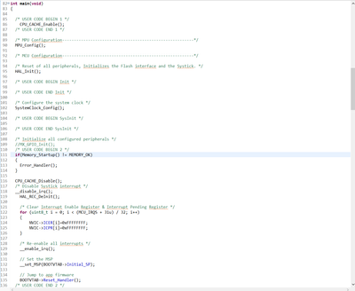

Personally I'd skip the setting of MSP, do a "LDR SP" over in the app code's Reset_Handler
Check the values in the Initial SP, PC vectors, say that (PC & 0xF0000001) == 0x90000001
Print out the values for diagnostic/telemetry purposes.
Set the SCB->VTOR in SystemInit(), ideally based off a symbol for the Vector Table the linker provides AS-BUILT
Would recommend getting UART output via STDIO (printf, puts, etc) and a viable HardFault_Handler() to report situation quickly/effectively.

Before jumping to the main application, make sure you DeInit all the clocks, peripherals, and interrupts you used in the bootloader.
in my case:
HAL_SD_MspDeInit(&hsd1);
__HAL_RCC_TIM1_CLK_DISABLE();
HAL_RCC_DeInit();
HAL_DeInit();

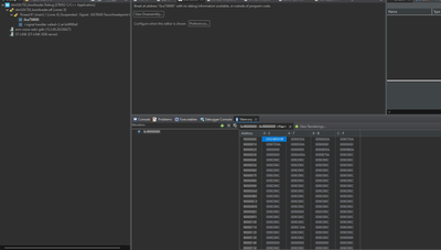

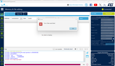

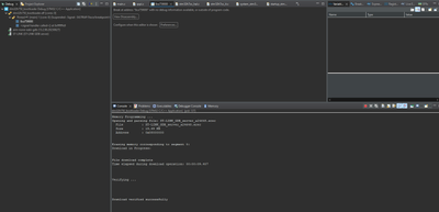

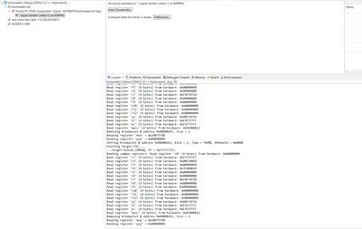

Thank you very much for your valuable comments. I have tried every method for 1 week. The processor is acting like an ***, no matter what you try, there is no change. In the STM32H750B-DK kit, in the ExtMem-Boot example, it can jump to the 0x90000000 address of the MT25QL512 flash without changing anything. But I can't jump to the 0x90000000 address with the STM32H750IBT6 and MT25QL512 flash, I'm really going crazy. Please help me with this, I really lost a lot of time.

Validate the content of the External Flash, use say CRC or SHA256/MD5 and validate the content is reliably readable
