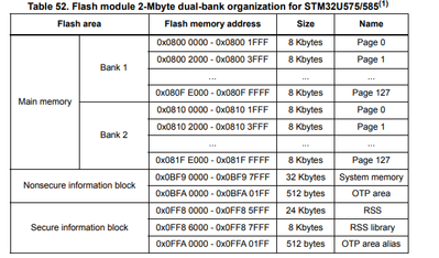

Hello @Adriano Melis
The page 127 in bank1 is in 0x080F E000 - 0x080F FFFF
the screenshot you showed, does not show page 127

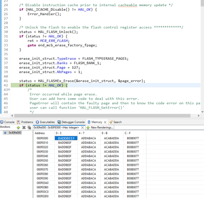

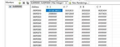

2024-02-21 7:50 AM
2024-02-21 7:51 AM - edited 2024-02-21 7:54 AM
my bad. this is an actual screenshot: Flash erase has been executed, FLASH content is unchanged.
(status value is HAL_OK)
