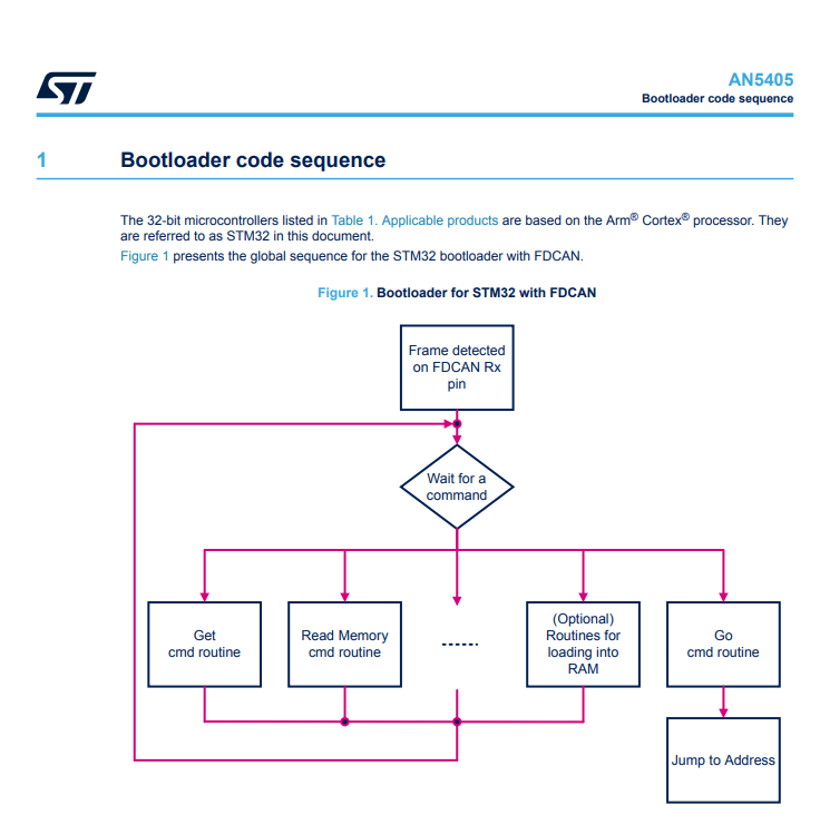

Hi @RLanz.2
Q1.1 will it wait infinitely?
R1.1 : Yes , according to the global sequence for the STM32 bootloader with FDCAN
Q1.2: How is it different from the bootloader path of execution when the bootloader
does not wait for any input and just continues to execute the application already
burnt to its flash?
R1.2 : Bootloader for STM632 with FDCAN have differente sequence
Regards
Diane
2023-05-25 7:58 AM
Q2.1 I meant I was asking for an example to send a message in the opposite direction: via FDCAN from the host to the stm32 FDCAN bootloader - message id, and all its structure - even the most simple one. Can you provide me with such an example?
R 2.1 this Example send the message via FDCAN from host to the STM32
Regards
Diane
2023-05-25 8:16 AM
Q3+4. Please let me explain what I meant: I am asking, after performing the jump to bootloader function from our SW running on the stm32, how can I check (using some outside tool the STM32CubeProgrammer?) to make sure that:
3+4.1 Is the FDCAN bootloader indeed STARTED to execute?
3+4.2 Is the FDCAN bootloader indeed WAITING for FDCAM message?
3+4.3 Is the FDCAN bootloader indeed WATING to ANY message in any other interface (and not the FDCAN)? If it somehow received a message in other interface (USART/I2C/SPI/DFU) and no longer waits to FDCAN message?
R3+4After sending the command, you must send the go command routine before moving to the address, but it is not possible to monitor the status in real time.
Regards
Diane
