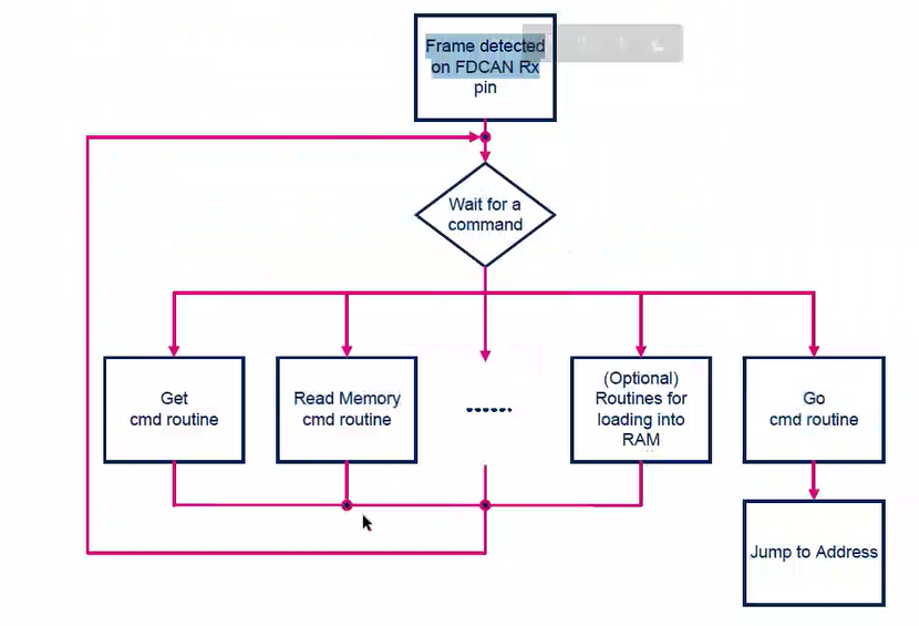

2023-04-19 3:49 AM
Hi
Thanks for your reply. In fact, I was actually already looking in those two ANs,
and unfortunately I still don't understand,
where it says in AN5405, in chapter 1 'Bootloader code sequence',
in Figure 1 'Bootloader for STM32 with FDCAN'
the initial state is 'Frame detected on FDCAN Rx pin'.
Thank you
Roni
2023-04-20 7:40 AM - edited 2023-11-20 9:08 AM
Hi @RLanz.2
Q1 and Q2: It not possible for bootloader to Know what peripherals that will be use . Bootlaoder initializes all peripherals that are supported and their inputs. If bootloader detected communication on one input connected to a supported peripheral, Bootloader denitializes others peripherals (Refer to figure 1 of AN5405).
As long as the bootloader has not received a go cmd routine from host , you will remain stuck in the bootloader.
Q3: ST host (HW and SW) don't support FDCAN.
Regards
