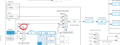

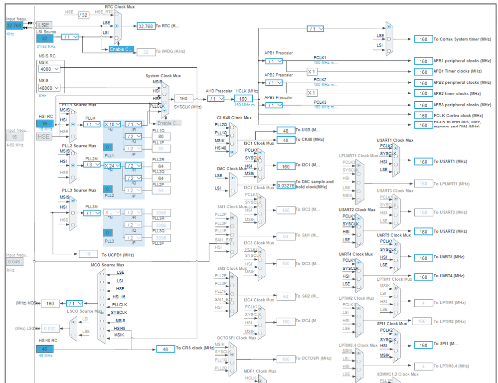

I have a custom board that I am getting ready to program that is using the STM32U575. I am a little confused about the clock configuration. My board has an external 32768 crystal. I am not sure I have the MX program clock configuration correct. I want the internal clocks running at full 160mhz speed with the internal clocks calibrated by the external 32768. Below is a screen shot from the MX clock configuration. I think I might not have the settings correct. Could you please check the configuration to see if I am configuring the clocks correctly.

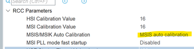

Oh interesting. You are correct, apologies. That's new with the U5. So you can do it, but you will need to use the MSIS as the PLL clock source, not HSI.
And enable automatic MSIS calibration in RCC:
There is no automatic calibration of the internal clocks to the LSE clock. If you need an accurate clock, use an HSE crystal or clock as a source.
You are using the HSI as a clock, which is okay but not super accurate. See details in the datasheet. Generally +/- 1% or so.
You can adjust the HSI by applying a trim value, but it's never going to be as accurate as an external crystal.

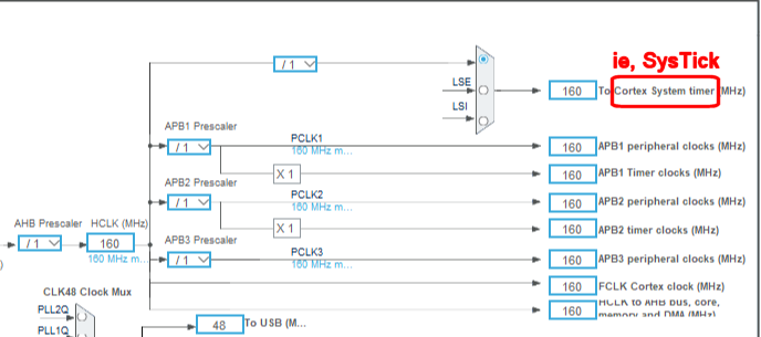

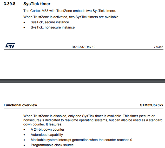

> I noticed the code generated by MX program initializes SysTick. Is that the same as the SysClk?
SysTick and SYSCLK are different, they have no relation to each other.
SysTick is an interrupt that happens every 1 ms (typically) and is used by HAL to keep track of time. SYSCLK is an internal clock that gets fed to HCLK before the prescaler.

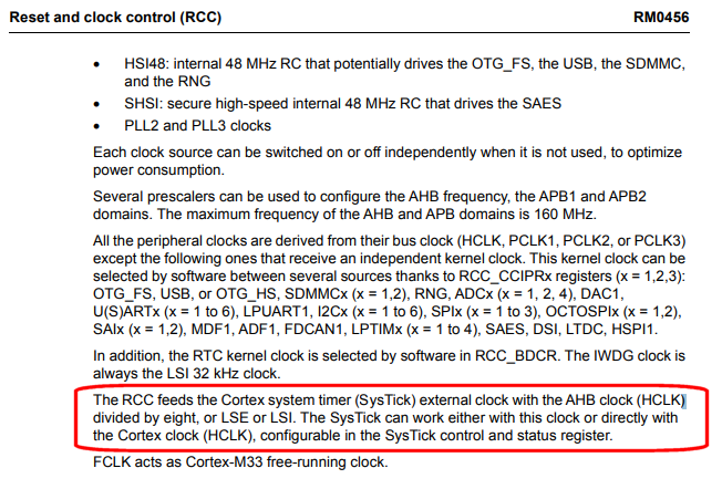

@TDK wrote:SysTick is an interrupt that happens every 1 ms (typically)
Well, SysTick is a counter (or "timer") - it can be used to generate an interrupt, if required.
The clock source for this counter can be HCLK, or HCLK/8, or LSE, or LSI:
2024-08-21 5:10 PM

One more thing I noticed. I have used various M4 and M7 microcontrollers over the years. The peripheral clock is usually SysClk/2. The clocks going out to the UART, I2C,... are 160mhz. Does the M33 core allow the full sysclk speed, or should those clocks be sysclk/2? The configurator does not seem to be balking at the 160 value.
2024-08-22 10:37 AM - edited 2024-08-22 10:38 AM
Maximum clock speeds of internal buses and peripherals do not depend on the processor core used in a microcontroller. They are the features of a particular STM32 family. In L4 family (CM4-based) all peripherals may run at core clock.
See the datasheet or CubeMX clock configuration tab for details - max. frequencies are shown there (most of them correctly). ;)
