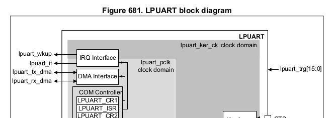

I'm trying to wakeup the STM32U5 controller (U575ZI Nucleo board) when a byte is received using the LPUART.
I'm using the LSE clock for the LPUART. Without entering the stop mode, the LPUART interrupt is triggered whenever a byte is received. This is working fine.
But when I enter the stop mode, I'm not able to wakeup the controller with the LPUART. Using the Userbutton as wakeup source is working.
The reference manual shows the "lpuart_wkup" output signal in the block diagram. But there is now further description about this signal and how it is enabled. Other STM32 controllers (like the STM32L4) have a dedicated WUFIE interrupt bit which can be enabled.
How do I enable the wakeup signal for the LPUART on STM32U5 controllers. Can you help me please.

Hi @andreas23,
what stop mode are you using? In RM0456 table 89 you can see that LPUART can only wake the MCU from Stop1 and Stop2, not from Stop3.
BR,
J

I see. Did you enable the UESM bit in the CR1?
2022-11-29 2:31 AM
Yes I did. The CR1 register is set to 0x2F (RXNEIE, TE, RE, UESM, UE). I know it is hard for you to help. Maybe, you have an example which demonstrates the wakeup from stop mode with the LPUART?

Hi @andreas23 do you use the HAL? HAL_UARTEx_WakeupCallback is triggered when a character is received when preparing the stop mode with the code below. Do not forget the WUFIE in CR3! This is missing in the HAL implementation but can be configured through LL_LPUART_EnableIT_WKUP.
(I'm using the LSE clock with a LPUART1 and a stm32l476rg)
void HAL_UARTEx_WakeupCallback(UART_HandleTypeDef *huart) {
ITM_SendChar('V');
__weak void PreSleepProcessing(uint32_t ulExpectedIdleTime)
UART_WakeUpTypeDef WakeUpSelection = {
.WakeUpEvent = UART_WAKEUP_ON_READDATA_NONEMPTY
HAL_StatusTypeDef res = HAL_UARTEx_StopModeWakeUpSourceConfig(&hlpuart1, WakeUpSelection);
if (HAL_OK != res) {
Error_Handler();
HAL_SuspendTick();
res = HAL_UARTEx_EnableStopMode(&hlpuart1);
Error_Handler();
res = HAL_UARTEx_EnableClockStopMode(&hlpuart1);
Error_Handler();
LL_LPUART_EnableIT_WKUP(hlpuart1.Instance);
__asm volatile( "dsb" ::: "memory" );
HAL_PWREx_EnterSTOP2Mode(PWR_STOPENTRY_WFI);
__asm volatile( "isb" );
