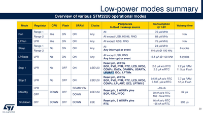

As per doc, page no 30, LPUART wakeup support only in STOP1 mode not in STOP2 mode. Is that correct ?
Also confuse it say clock source LSI/LSE support, does that mean it does not support HSI to wakeup ?
Edited: Yes it is also shown in the STOP2 mode, but again does it not support to wakeup at HSI clock ?

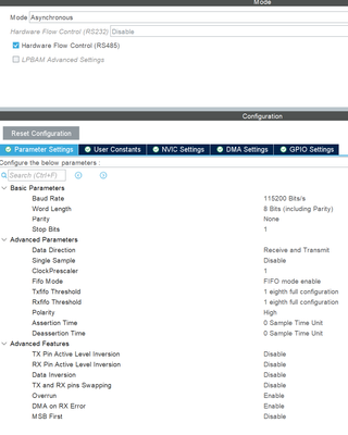

Using Custom board, HAL library, bare metal, STM32U0 series controller. Connected with 12 volt power supply and ST-Link Debugger for code dump.
2025-11-11 6:33 AM
For more information using, HAL_UARTEx_ReceiveToIdle_IT() for receiving data and transmitting using HAL_UART_Transmit_IT() , So also need to understand does the ReceiveToIdeal support for wakeup event?

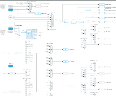

According to the reference manual STM32U0 series advanced Arm<Sup>®</Sup>-based 32-bit MCUs - Reference manual Figure 11. Clock tree, LSI is not an option for LPUART.
KnarfB
2025-11-11 7:20 AM - edited 2025-11-11 7:21 AM
Ohh yes, I was looking at wrong peripheral, I was using HSI.
