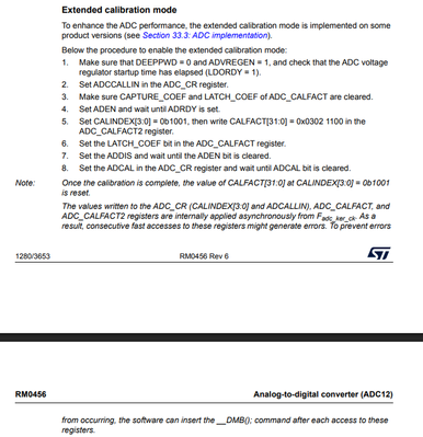

I was trying to implement extended calibration for ADC1 on my STM32U575 according to RM0456 Rev 5. I have a revision ID 0x3001 chip which should support extended calibration. The chip would hang very badly (can no longer connect with debug probe!) after step 6 ("Set the LATCH_COEF bit"). I took a look at the HAL code in stm32u5xx_hal_adc_ex.c and it is doing a few things differently:
When I changed my code to do those two things the ADC now completes calibration properly and doesn't hang my debug connection.
It would be helpful if the RM could be updated accordingly!

A new note is added in RM0456 rev 6: "The values written to the ADC_CR (CALINDEX[3:0] and ADCALLIN), ADC_CALFACT, and ADC_CALFACT2 registers are internally applied asynchronously from Fadc_ker_ck. As a result, consecutive fast accesses to these registers might generate errors. To prevent errors from occurring, the software can insert the __DMB(); command after each access to these registers."
HAL driver is already took into account on this point.

That doesn't seem to address my second point, which was preserving the low-order 8 bits of the CALFACT2 register. This is what is happening in the HAL code:
MODIFY_REG(hadc->Instance->CALFACT2, 0xFFFFFF00UL, 0x03021100UL);
