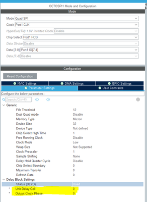

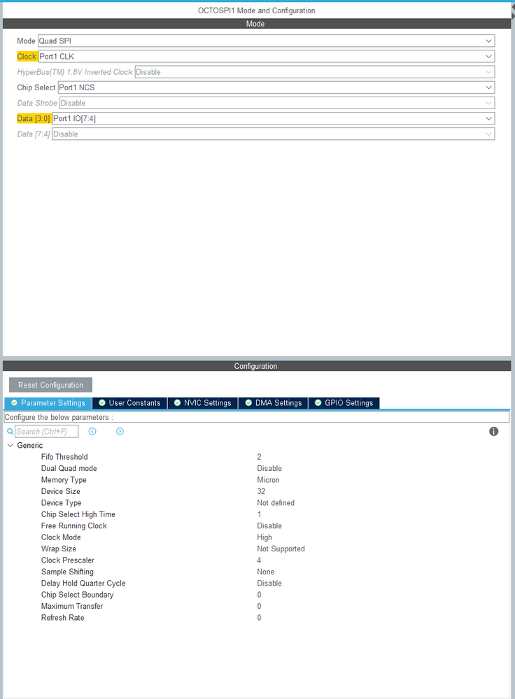

I do not have the option of enabling the delay block in CubeMX if I configure the OSPI peripheral to work in QSPI mode. This makes me think that perhaps one cannot use the delay block in QSPI mode, see screenshot below:
I can manually modify the generated code for the OSPI peripheral from:
hospi1.Init.DelayBlockBypass = HAL_OSPI_DELAY_BLOCK_BYPASSED;to
hospi1.Init.DelayBlockBypass = HAL_OSPI_DELAY_BLOCK_USED;However, it seems that modifying OspiDLYBCfg.Units and OspiDLYBCfg.Phase doesn't seem to make any difference to whether data is Tx/Rx'd correctly at a given clock frequency.
I apologize for any inconvenience. Now, the Delay block configuration issue using STM32CubeMx toolchain is fixed in STM32CubeMX V6.12.0.
