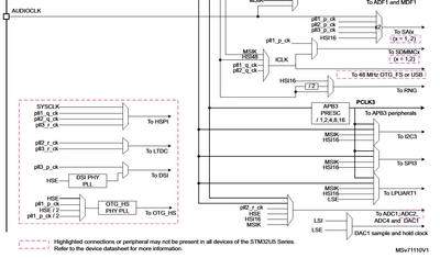

It is further detailed in the reference manual's RCC section:
The red-dashed lines show differences between FS and HS chips.
In order for crystal-less to work, the clock recovery system (CRS) must be used which works only with the HSI48 oscillator. HSI48 can be selected as a source for the FS block, but the HS block requires a PLL/HSE clock - HSI48 is not available there.

From the reference manual RM0456 rev 4, the USB High Speed has for clock source, the HSE and the PLL1Q. Please refer to the figure 36 "Clock tree for STM32U5 Series".
In that case I would say that it is not mandatory to use an external HSE crystal for the USB HS.
Please make sure that you respect the minimum input frequency (30MHz) the characteristics mentioned in the datasheet for the USB HS (Table 161 and 162).

Furthermore, USB HS specification requires 500ppm accuracy on the clock (0.05%), I don't think it is possible to achieve that with an RC oscillator, even with the CRS trimming.
USB FS accuracy requirement is 0.25% which is achievable with trimming, so crystal-less is possible.

That is right, the USB HS is only available on STM32U59x/5Ax devices which require an external HSE crystal or to be clocked with the PLL1/Q.
And STM32CubeMX should trigger a error or it shouldn't be possible to choose an internal oscillator in that case.
