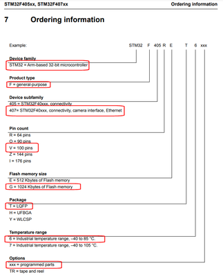

The meanings of all the letters at the end of the part number are described in the Datasheet

The amount of glare in the picture makes it practically unreadable. Use macro mode if available, and a closer / oblique angle to minimize glare.

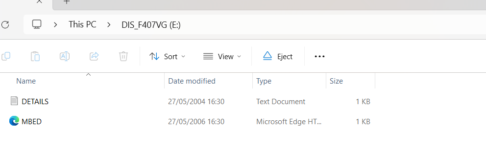

i still kinda confuse tho, maybe cause i use arduino IDE, but the Serial print not work there, works fine with older board VET series one, also when i plug it in, it appears like on the image here. it like it's acts like flashdisk or other save device

maybe you can explain it as i'm still confuse with this as it act like a save device

The STLink built in to the DK board should present BOTH the disk drive (which you can use to download firmware by drag-n-dropping the BIN (or hex) file onto the drive), and a virtual COM port.

well there's some thing that i still confused for, first when plug there was appear a drive like it act as a flashdisk or something you can save file on it too (picture below), second when i plug the debugger (ST-LINK) it was recoqnised as COM PORT which my previous STM32 Discovery dev board not like that as the previous only the UART Serial one's recoqnised as the COM-PORT and not the debugger. maybe you can help me with it, sorry maybe i'm asking too much.

The ST-LINK/V2-1 implementation used for mBed provides a means to drag-n-drop .BIN files which will be burned onto the FLASH of the STM32. It also adds a VCP, but unfortunately on the STM32F407I-DISCO this doesn't connect to anything, as it's an older design originally shipping with ST-LINK/V2 implementation that lacked both of these additions.
On NUCLEO boards, and newer DISCO/DK boards, this VCP typically connects to a UART on the STM32, allowing for diagnostic or telemetry type output to be viewed on a terminal. This can aid debugging, provide dynamic analysis, or a means to communicate and configure your code from a PC.
