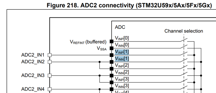

I think RM0456, section 33.4.7 may be wrong describing ADC differential input polarity:
"When channel “i” is configured in differential input mode, its negative input voltage is connected to VINN[i-1]."
According to Figure 218 and my tests the opposite seems to be correct: negative input voltage is connected to VINN[i+1].

Hello @TDJ
Can you give us more details about your feedback.
Can you confirm if connection is according to the figure ?
Regards
Diane
2023-07-06 9:14 AM - edited 2023-07-07 8:17 AM
@Diane POMABIA I verified that ADC differential input polarity is consistent with Figure 218.
However, the text description at the end of RM0456, section 33.4.7 which reads:
in my opinion is incorrect. Instead of "VINN[i-1]" should be "VINN[i+1]".
That is, if differential positive input is (e.g.) IN3, negative input for this channel is IN4, not IN2.

Hello @TDJ
Yes, I confirm this mistake that will be resolved in next revision of Reference Manual.
