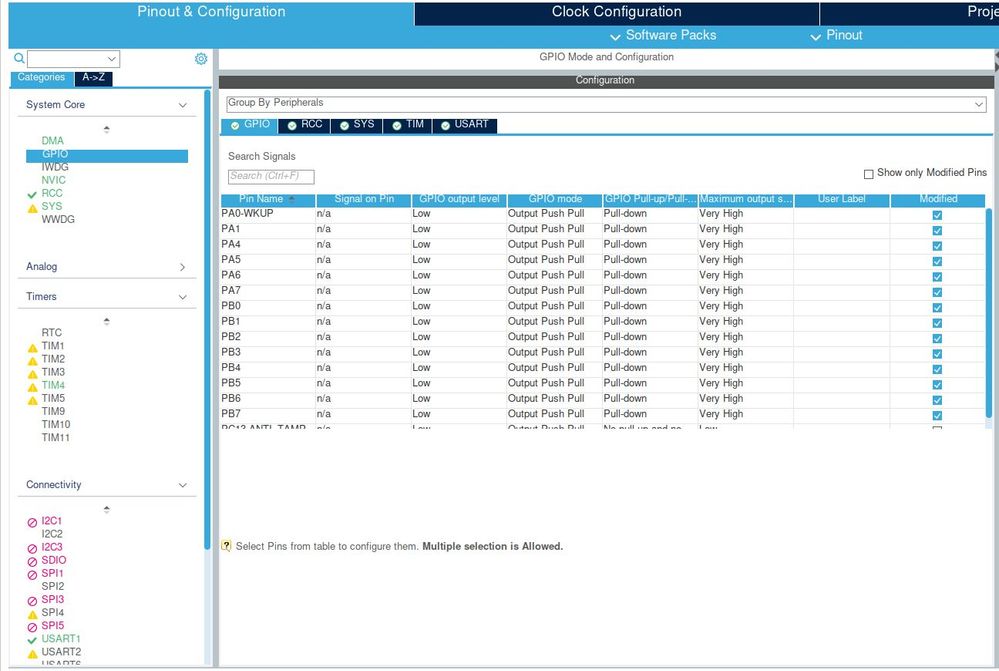

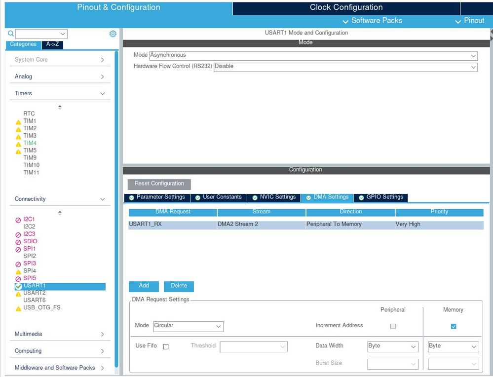

2023-07-06 12:16 AM
I think I missed the problem explanation, sorry for that.
Please find the detailed information below -
To Achieve -
1- Need to create DAC (Digital to Analog) Interface.
2- Receive data from UART ( I have chosen UART because of DMA support) (USB option is also available but I think DMA support option is not available on STCube IDE).
3- Send the data (received from UART) to DAC which is connected to GPIOA (A0 to A7) LSB and GPIOB MSB (B0 to B7)
4- Generate CLK of 12MHz / 12.5MHz.
Facing issues -

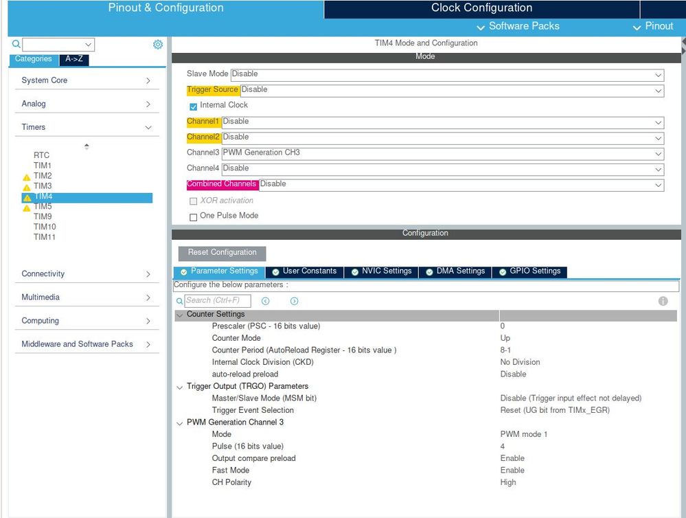

1- Unable to receive data when the PWM timer interrupt is enabled (using this function in main.c file - HAL_TIM_PWM_Start_IT(&htim4, TIM_CHANNEL_3);
but , getting data when I disabled the PWM timer interrupt (HAL_TIM_PWM_Start(&htim4, TIM_CHANNEL_3);.

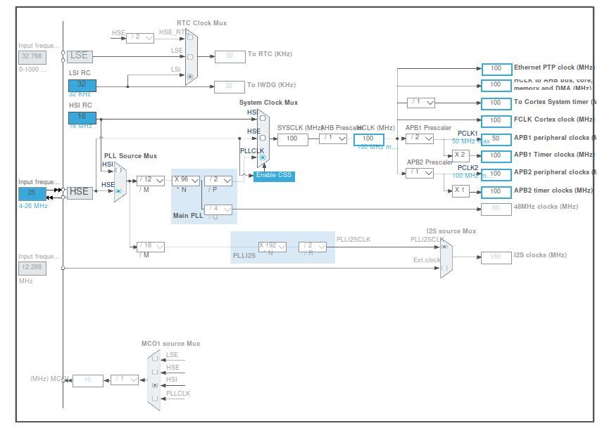

I have done calculation for timer 4 to generate CLK, the details -
APB1 Timer Clock :- 100MHz, so T=10ns.
1 Tick = 10ns, so for 12.5MHz, T=80ns.
Therefore Counter Period = 8 Ticks.
For 50% duty cycle Pulse value = 4.

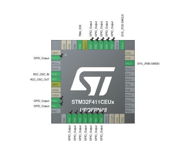

Please see the reference image 01 -Pin Config
CLK Config
GPIO Config
Timer4 Config

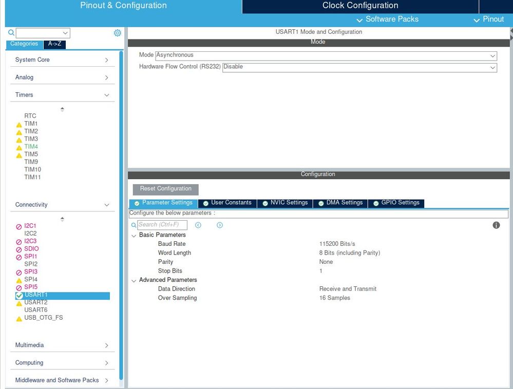

UART1 Config

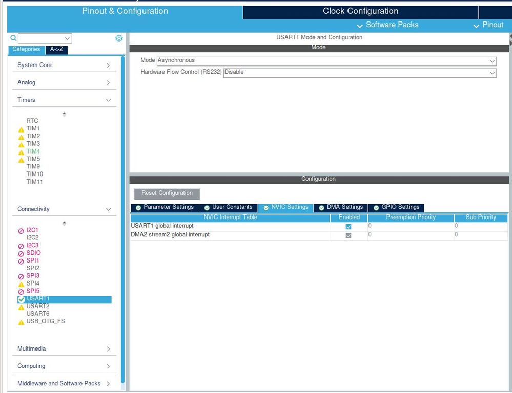

UART1 DMA Config
UART1 NVIC Config

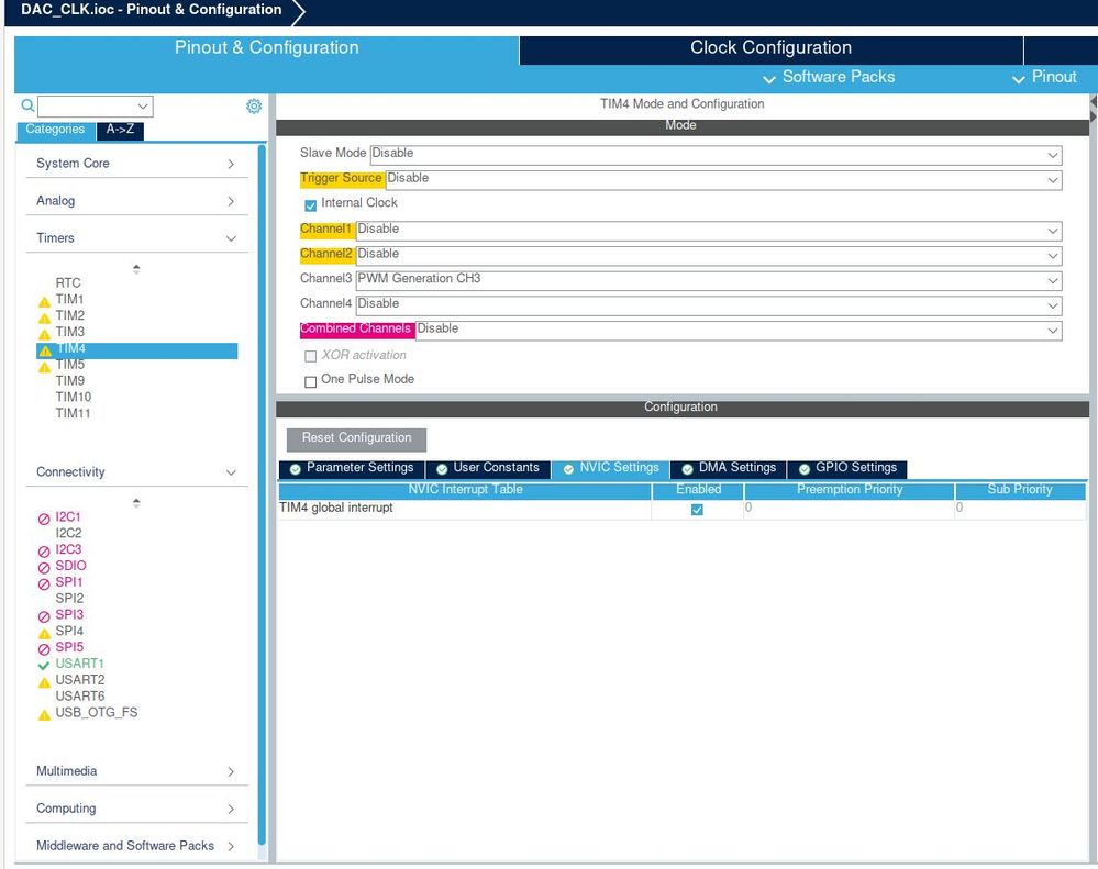

Timer4 NIVC Config
main.c program

I have used PWM output mode with timer 4 at channel 3 pin B8 for clock generation. On Half pules complete callback i write 16 bit data to GPIOA->ODR (LSB) and GPIOB->ODR (MSB).
Please find full details in reply section https://community.st.com/t5/stm32cubeide-mcu/problem-with-uart-transmission-while-timer-interrupt-is-enable/m-p/572482/highlight/true#M18951

Sorry I have multipler 2x which is before Timer clock on APB1 bus.
So Timer4 have 100MHz clock, So 1 Tick is 10ns.
As per my calculations for 12.5MHz T=80ns , so 8 Ticks gives us 80ns.
Therefore Counter Period = 8-1 and Pulse Value = 4.
Please find full details in reply section https://community.st.com/t5/stm32cubeide-mcu/problem-with-uart-transmission-while-timer-interrupt-is...

I apologie for that. I am using UART with DMA. I have tried polling mode and Interrupt mode, but still unable to receive data.
