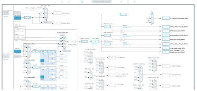

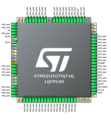

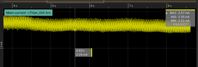

We are currently utilizing a custom-designed STM32U5G7 microcontroller for our application with the MSI clock configured to 1 MHz. Despite configuring the device in Sleep and Stop modes, with all GPIO pins set to input and one pin configured as an EXTI interrupt for wake-up, we are observing a current draw of approximately 2mA. Our goal is to reduce the current consumption to the micro ampere range. Could you provide guidance on further optimizing power management and implementing lower-power modes?
I have attached the code ,pin out configuration and current drawn  measured using Otii.

To optimize power consumption, it is recommended to configure unused pins in analog mode (instead of input floating).
To do it with STM32CubeMX, please follow this article: How to minimize the power consumption in low power mode: An example using NUCLEO-F401RE board.
Please try and let me know if there is any difference.
How, exactly, are you observing that?
You will need to physically disconnect any debugger to see true low-power operation.
You may also need a power-cycle (not just a reset) after disconnecting a debugger.
