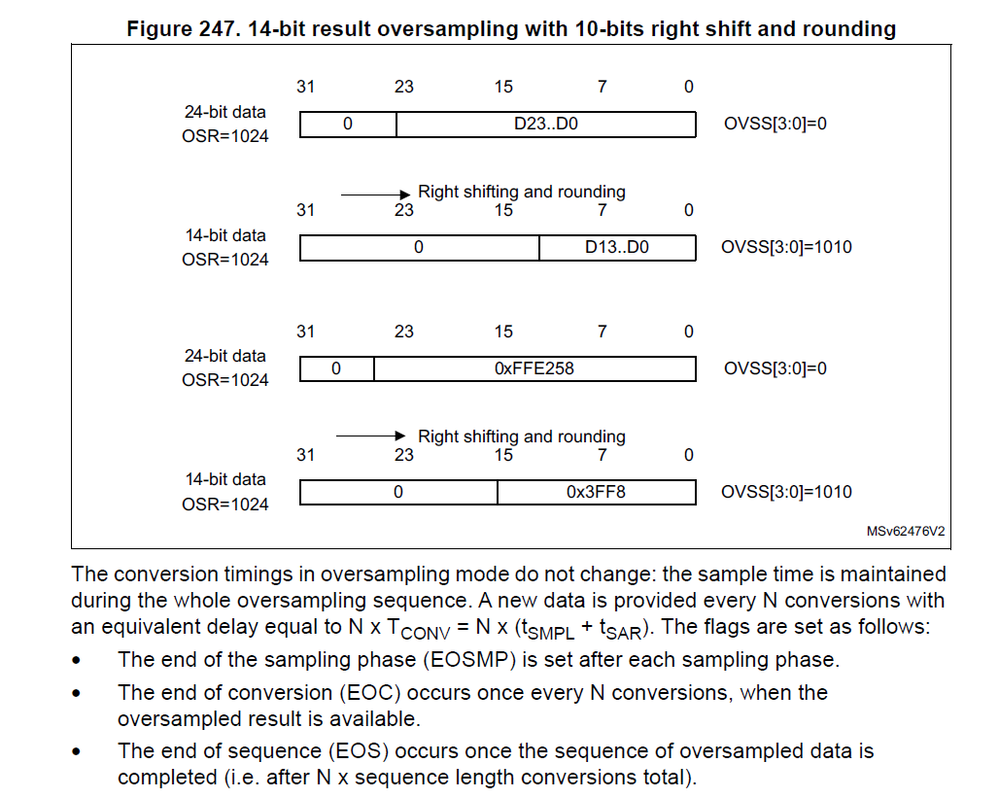

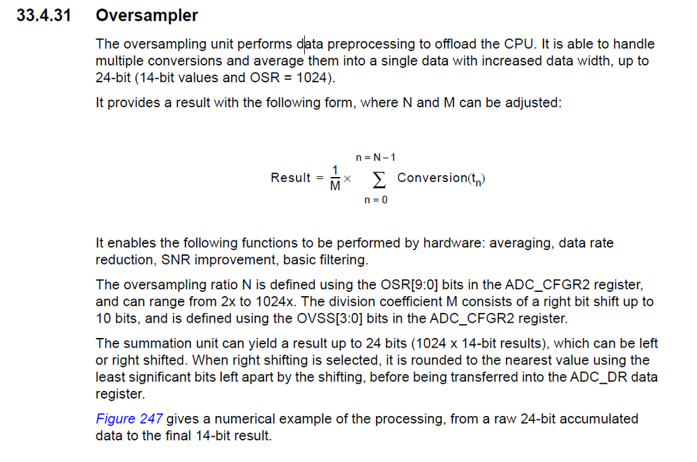

Hello @Shru2 and welcome to the Community :)
You will find the formula and more details in the RM0456 section 33.4.31:

In short - to gain additional N bits of actual analog performance, one has to oversample by a factor of 2^(2*N) and then right shift the sum by N bits.
