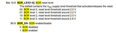

In version 4 of the reference manual for STM32U0, it is suggested that BOR is enabled and on Level 3 from the factory.
Is that correct?
I'm currently working on an construction running @ 2V, so it would never start up, if so. And when I read out the Option Bytes on a new MCU, BOR is disabled?

Based on the product reference manual, level three corresponds to 2.8 V, so 2.0 V is not sufficient.
You can upgrade your power supply to a minimum of 2.8V, or modify the BOR_LEV bits in the FLASH option register to set the desired voltage.

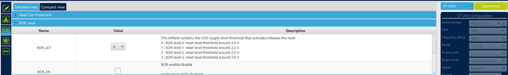

Also, you can use STM32CubeProgrammer to verify and make sure of the current BOR value.

In STM32U0, the reset values are generally 00 for BOR_LVL and 1 for BOR_EN. This is why the project runs at 2.0 V, because BOR level 0 corresponds to 2.0 V.

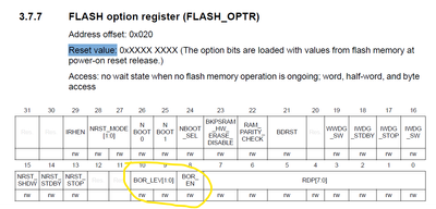

Option Bytes are different from the vast majority of other registers, as they are not reset by micro code in the MCU, but rather by reading them from FLASH - which is why the user can change them.
And that is why they can not have a reset value defined in the Reference Manual
(see above, FLASH_OPTR Reset Value is 0xXXXX XXXX).
The value depends on what the user might have programmed it to be.
My problem is that if I take a brand new MCU - without programming anything - and read the BOR settings, I get:
BOR level = 0b11 (2.8V)
BOR_EN = 0 (brown out is disabled)
Corresponding to '110'
I would expect that these were set to the Factory Value the very first time (as I have not changed them):
BOR_EN = 1 (brown out is enabled).
Corresponding to '111'
