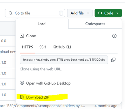

Have you downloaded the STM32CubeU0 as .ZIP file using this Command:
If so, the code will have some driver issue. The only way to guarantee that it will work is to Clone repository using the command:
git clone --recursive https://github.com/STMicroelectronics/STM32CubeU0.git
Or download it from the ST Website (on this link).
