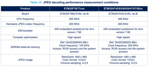

I'm trying to use the HW JPEG decoder on an STM32H743 MCU. When looking at the AN4996 Application Note, I found the following table:
However, I'm unable to come even close to these values... This is what I measured:

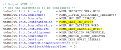

I checked my code against the Examples from the Firmware Package:
All my settings look similar. I'm decoding the JPEG image from DTCM RAM to external SDRAM. Compiler optimization has no effect (everything is done by DMA anyway)...

The performance measurements in the application note were obtained under the conditions presented in the below table:
For that please make sure that you have used the same conditions to obtain the same performance::
-1- Board: STM32H743I-EVAL that comes with an 32 bits SDRAM
-2- MDMA output channel destination data increment and size : WORD (hmdmaOut.Init.DestinationInc: MDMA_DEST_INC_WORD; hmdmaOut.Init.DestDataSize: MDMA_DEST_DATASIZE_WORD))
-3- DMA2D format RGB565 (and same for LTDC format)
-4- LCD display turned off during the JPEG operations to reduce the contention on the SDRAM between the LTDC and the DMA2D mainly
-5- The image used is a 4:2:0 image
I hope this help you.

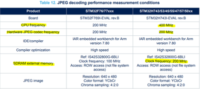

Could you please test the performance with the same frequencies conditions as motioned in the below table:
Could you please share the performance values you have obtained?

I was able to identify and fix the problem and my performance now looks like this:
| JPEG decode | DMA2D YCbCr (LTDC disabled) | DMA2D YCbCr (LTDC enabled) | |
| 640x480 | 4,4 ms | 6,8 ms | 10,8 ms |
I tested with the same frequency conditions as the table from the application note and now the values look plausible...
As mentioned in my first question, I looked at both example projects from the STM32CubeMX Repository (V1.11.2). As you can see, in both examples the MDMA output destination size + increment is configured for BYTE size.
Looking for this problem did cost a lot of time and I wasn't able to find any reference (other than the example code) for the correct / optimal MDMA configuration...
I would suggest to fix the example code to clarify this for future use. Or is there any specific reason why the MDMA in the example projects isn't configured for optimal performance?
