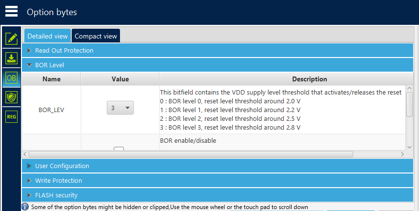

#define FLASH_OPTR_BORF_LEV_1 (0x2UL << FLASH_OPTR_BORF_LEV_Pos) /*!< 0x00001000 */And if I connect a Nucleo-U083 and look at STM32CubeProg (v2.19), I see this:

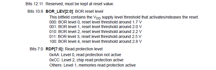

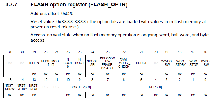

However, if I look in the STM32U0 reference manual (RM0503 Rev 2), I see this:
The header file and CubeProg suggest there are two bits (four levels) of BOR detection with a separate enable bit, but the reference manual suggests there are three bits of level with no separate enable. I'm inclined to believe the header file and CubeProg.

#define OB_BOR_LEVEL_RISING_3 (FLASH_OPTR_BORR_LEV_0 | FLASH_OPTR_BORR_LEV_1) /*!< BOR rising level 4 with threshold around 2.9V */From these definitions here, I can infer that the U0 has two separate brown-out level settings, one for rising power, and one for falling power. The reference manual doesn't mention any of this, and CubeProg only shows a single brownout reset level setting (BOR_LEV).
Do both the STM32U0 reference manual and CubeProg need to be fixed?
